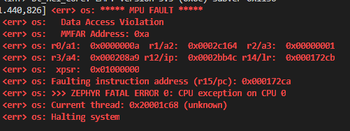

  • For an additional information, I tried this kind of stuff without creating a client but I am getting the error I put below.
    How far does it get before it throws that error?
    It looks like the application is trying to change the value of something it is not allowed to change.
    What does the log say directly before it says "MPU FAULT"?
    BR,
    Edvin
  • I was writing log messages. I find another forum question about it and it says that it was given this error because of the bad pointer. I will try different technique and let you know,
    Thank you in advance,
