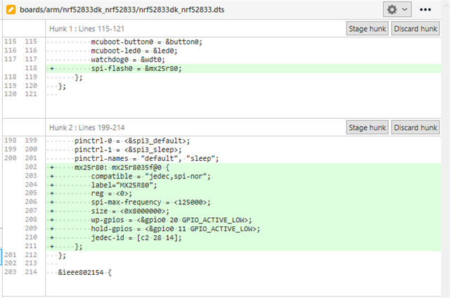

I try to add an external SPI-NOR flash (MX25R8035F) to nrf52832 project. I started with the example in zephyr/samples/drivers/spi_flash which is for nrf52840 and changed the dts file as follows:
Here I post the "arduino-spi", I also tried with SPI0 and SPI1, same behavior.
nrf52dk_nrf52832.dts:
aliases {
spi-flash0 = &mx25r80;
arduino_spi: &spi2 {
status = "okay";
cs-gpios = <&gpio0 20 GPIO_ACTIVE_LOW>;
pinctrl-0 = <&spi2_default>;
pinctrl-1 = <&spi2_sleep>;
mx25r80: mx25r8035f@0 {
compatible = "jedec,spi-nor";
label="MX25R80";
reg = <0>;
spi-max-frequency = <33000000>;
size = <0x800000>;
jedec-id = [c2 28 14];

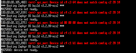

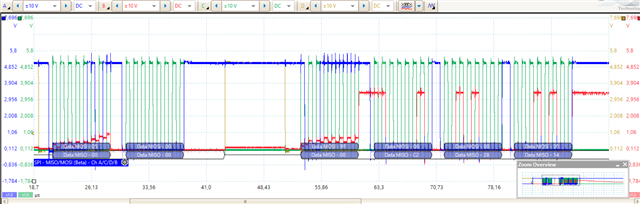

The flash device gets partly  initialized since flash_dev.state.initialized == 1 and partly not since flash_dev.state.init_res==16 (should be 0). That is why device_is_ready() return false.
I see this in the debugger as below:

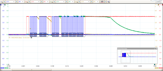

I see on my oszilloscope that SPI itself is working because I get responses from the external flash, so I can't be doing everything wrong. But the write and read process is working incorrectly, meaning that if I write something to a location, I get a wrong response when reading again.
Do you have any ideas what the problem could be?
I also tried to research what EBUSY in the devicetree means in general and found that it often has to do with wrong pins. However, this can't be the case here, since my SPI is working, do you agree?

    I'm sorry about the late reply, I've been out of office for a course the past few days and am only now getting to my backlog. There's definitely something fishy with how the nRF52833 is reading back from this device, but the scope plot you've uploaded is very hard to read when all the lines are put on top of each other. Is there any chance you could provide a plot where the lines are separated from each other so we don't have to guess what line is what exactly, and can see how each of them behaves.
    If you are also able to get a plot of how it communicates with the Arduino we can compare them and likely get an idea of what the difference is exactly.

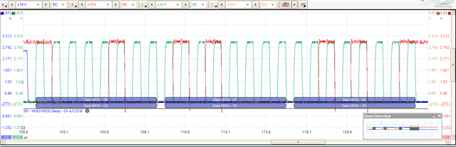

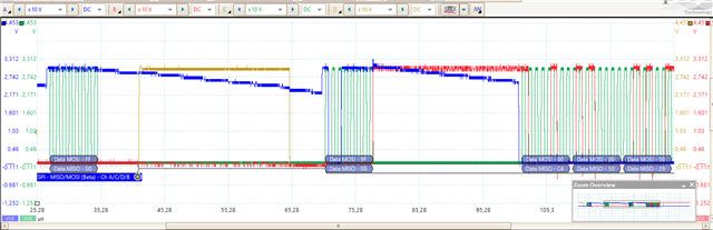

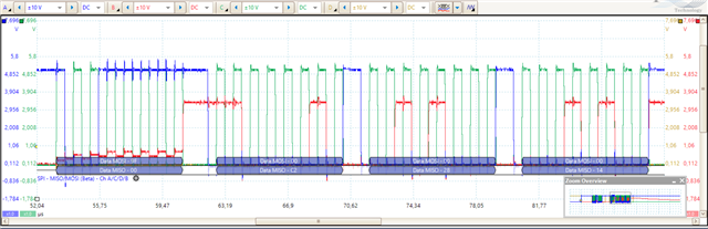

    here are some better pictures. I recorded the data such that the MOSI/MISO are above the CLOCK. I hope you can see it.
    First a 0x05 command for read-status-register is sent and then the 0x9f command for read-JEDECID. I zoomed into the second because this is the interesting one.
    Note that the arduino sends data with a voltage level of 5V and the nRF52833 with 3.3V.
    SPI configuration:
    Arduino:
    nRF52833:
    I can't upload the .psdata-files. Let me know if you can use them and maybe I can upload them somewhere else.
