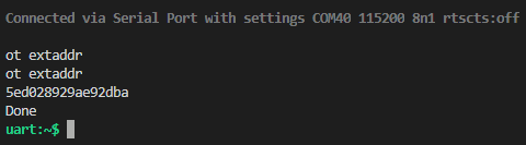

kaushalyasat said:3. The topology monitor cant seem to get the ext address from a SED. Is there a way to do it?
The thread samples have OpenThread CLI commands enabled, so you can connect with any UART assistant software like Putty and run "ot extaddr" to get the device ext address.
