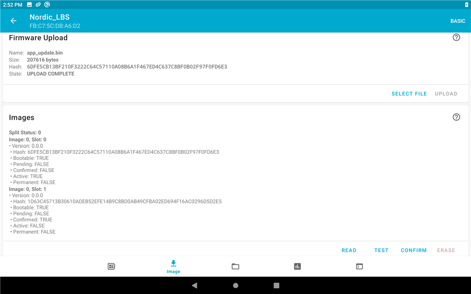

[NCS v2.2.0] - Device Firmware Update (DFU) via OTA using BLE
Hi

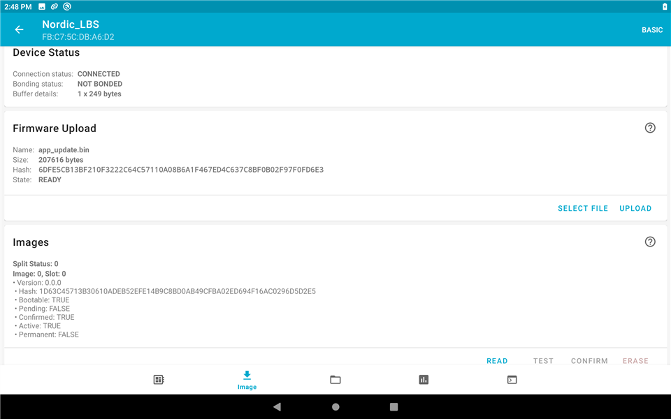

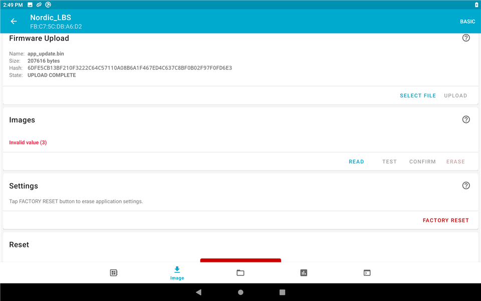

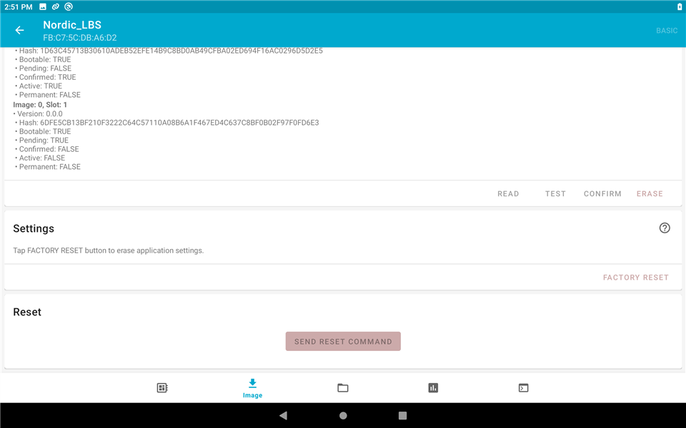

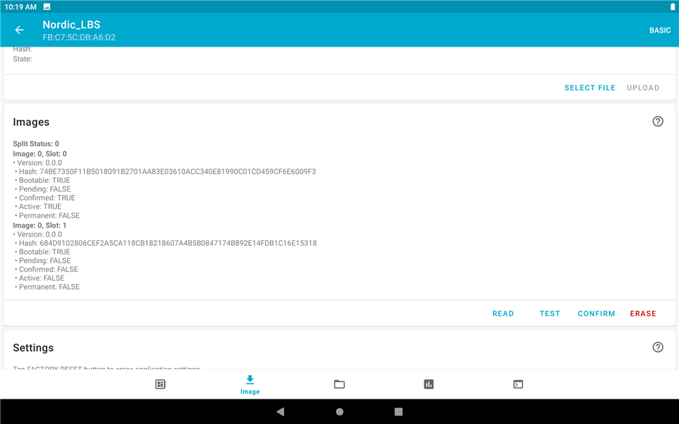

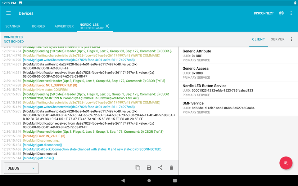

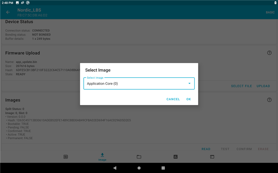

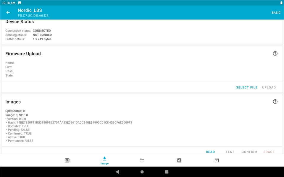

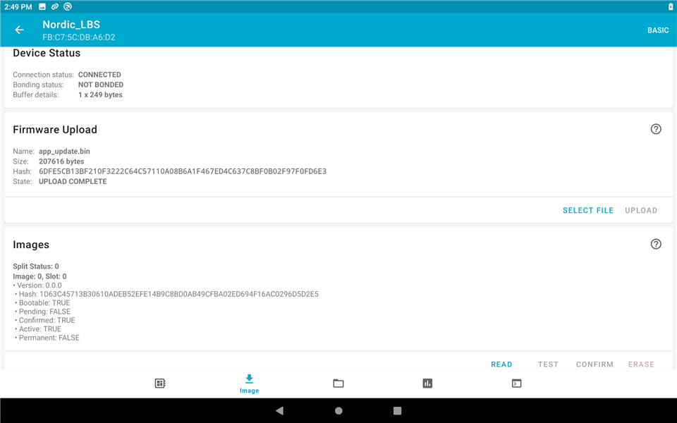

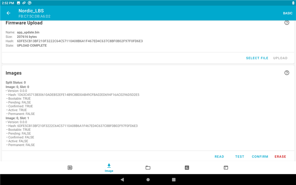

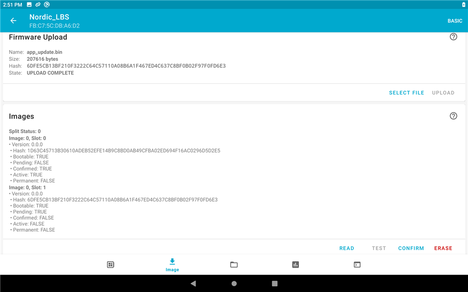

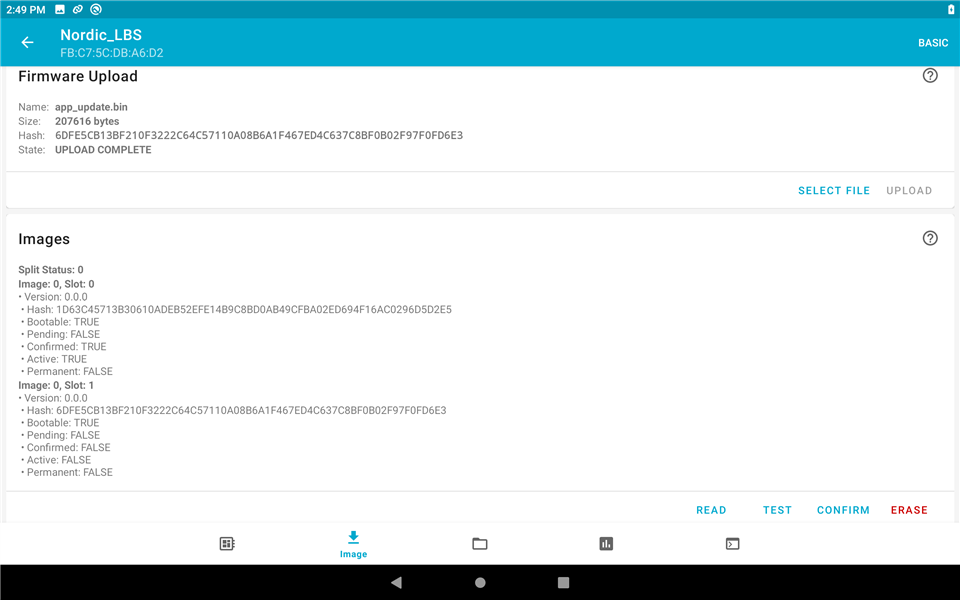

In order to add DFU function to our custom board (integrating nRF52840) over OTA by using BLE, we refer to the guide named "Adding DFU support to your application" and use the same procedure (include the sample) from the "DFU over Bluetooth" section on nRF52840DK. The upload tool we use is nRF Connect Device Manager (Android-verison 1.5.2).
The result is that when we select the "Test and confirm" option on Device Manager to upgrade firmware (whatever app_update.bin or dfu_application.zip), the state will display "Invalid value (3)" after the procedure is completed. We are not sure if the firmware was successfully upgraded.
In view of this, we searched this issue on Nordic Q&A and found someone with the same problem. The case is here. We refered to the solution in this case to upgrade firmware using "Confirm Only" option. But the result was the same. We recorded two logs. One from nRF Logger app and the other from Minicom. They are as follows.
Device Manager, 2023-02-22
Nordic_LBS (Device Manager)

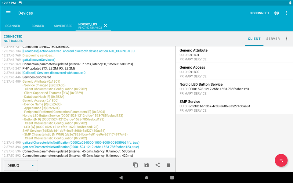

I	10:17:34.488	[e] Connected to FB:C7:5C:DB:A6:D2
I	10:17:34.925	[e] Connection parameters updated (interval: 7.5ms, latency: 0, timeout: 5000ms)
I	10:17:35.006	[e] PHY updated (TX: LE 2M, RX: LE 2M)
I	10:17:35.206	[e] Services discovered
I	10:17:35.284	[e] Connection parameters updated (interval: 45.0ms, latency: 0, timeout: 5000ms)
I	10:17:35.311	[e] MTU changed to: 252
I	10:17:35.462	[e] Data written to descr. 00002902-0000-1000-8000-00805f9b34fb
I	10:17:35.484	[e] Notifications enabled

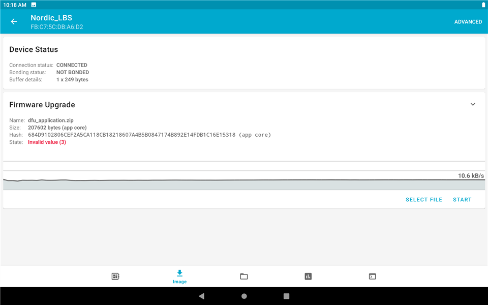

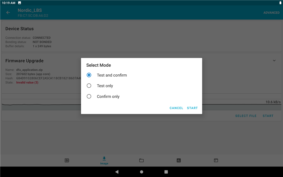

V	10:18:33.530	[j] Starting DFU, mode: CONFIRM_ONLY
I	10:18:33.726	[e] Sending (10 bytes) Header (Op: 0, Flags: 0, Len: 2, Group: 1, Seq: 2, Command: 0) CBOR {}
I	10:18:33.757	[e] Data written to da2e7828-fbce-4e01-ae9e-261174997c48
I	10:18:33.828	[e] Notification received from da2e7828-fbce-4e01-ae9e-261174997c48, value: (0x) 01-00-00-86-00-01-02-00-BF-66-69-6D-61-67-65-73-9F-BF-64-73-6C-6F-74-00-67-76-65-72-73-69-6F-6E-65-30-2E-30-2E-30-64-68-61-73-68-58-20-74-BE-73-50-F1-1B-50-18-09-1B-27-01-AA-83-E0-36-10-AC-C3-40-E8-19-90-C0-1C-D4-59-CF-6E-60-09-F3-68-62-6F-6F-74-61-62-6C-65-F5-67-70-65-6E-64-69-6E-67-F4-69-63-6F-6E-66-69-72-6D-65-64-F5-66-61-63-74-69-76-65-F5-69-70-65-72-6D-61-6E-65-6E-74-F4-FF-FF-6B-73-70-6C-69-74-53-74-61-74-75-73-00-FF
I	10:18:33.860	[e] Received Header (Op: 1, Flags: 0, Len: 134, Group: 1, Seq: 2, Command: 0) CBOR {"images":[{"slot":0,"version":"0.0.0","hash":"dL5zUPEbUBgJGycBqoPgNhCsw0DoGZDAHNRZz25gCfM=","bootable":true,"pending":false,"confirmed":true,"active":true,"permanent":false}],"splitStatus":0}
V	10:18:33.908	[k] Validation response: {"images":[{"slot":0,"version":"0.0.0","hash":"dL5zUPEbUBgJGycBqoPgNhCsw0DoGZDAHNRZz25gCfM=","bootable":true,"pending":false,"confirmed":true,"active":true,"permanent":false}],"splitStatus":0}
V	10:18:33.932	[j] Moving from state VALIDATE to state UPLOAD
I	10:18:33.954	Uploading firmware...
I	10:18:53.679	Image (207602 bytes) sent in 19535 ms (avg speed: 10.627182 kB/s)
I	10:18:53.757	[Uploader] Upload completed. 207602 bytes sent in 19717 ms with avg speed: 10.528553 kBytes/s
V	10:18:53.795	[j] Moving from state UPLOAD to state CONFIRM

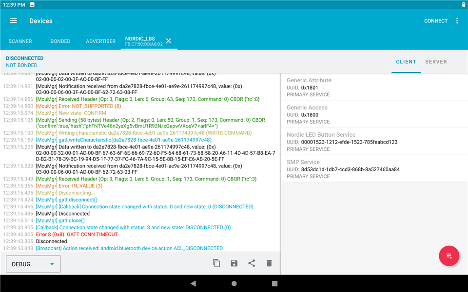

I	10:18:53.847	[e] Sending (58 bytes) Header (Op: 2, Flags: 0, Len: 50, Group: 1, Seq: 174, Command: 0) CBOR {"confirm":true,"hash":"aE2RAoBs7ypcoRjLGCGGB6S1sIRxdLiS4U/bHBbhUxg="}
I	10:18:53.878	[e] Data written to da2e7828-fbce-4e01-ae9e-261174997c48
I	10:18:53.911	[e] Notification received from da2e7828-fbce-4e01-ae9e-261174997c48, value: (0x) 03-00-00-06-00-01-AE-00-BF-62-72-63-03-FF
I	10:18:53.938	[e] Received Header (Op: 3, Flags: 0, Len: 6, Group: 1, Seq: 174, Command: 0) CBOR {"rc":3}

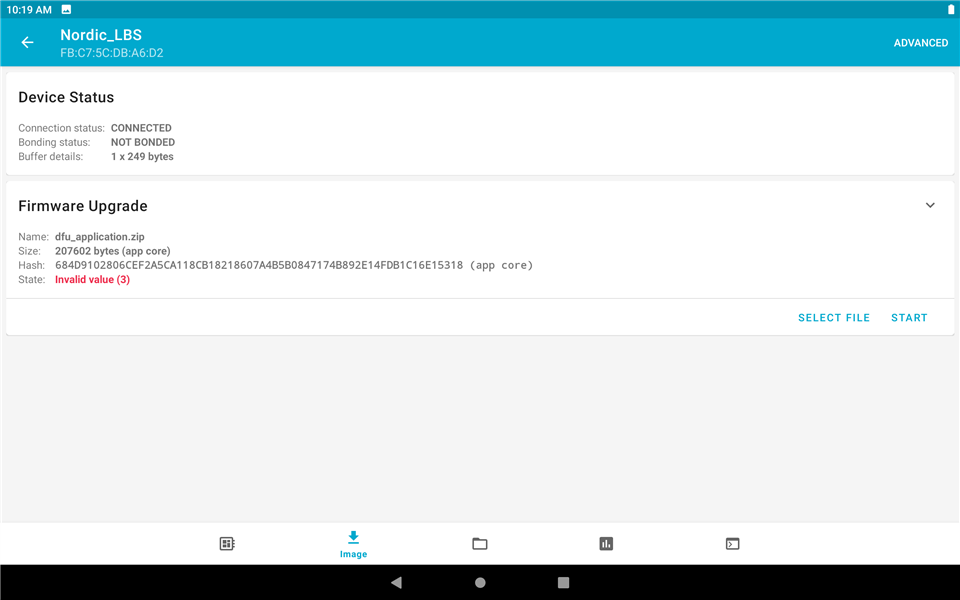

E	10:18:53.977	Upgrade failed
Mcu Mgr Error: IN_VALUE (3)
	at j2.e$b.c(Unknown Source:24)
	at k2.f.j(Unknown Source:10)
	at k2.f.c(Unknown Source:0)
	at k2.e.run(Unknown Source:4)
	at android.os.Handler.handleCallback(Handler.java:883)
	at android.os.Handler.dispatchMessage(Handler.java:100)
	at android.os.Looper.loop(Looper.java:214)
	at android.os.HandlerThread.run(HandlerThread.java:67)
I	10:19:01.875	[e] Sending (10 bytes) Header (Op: 0, Flags: 0, Len: 2, Group: 1, Seq: 175, Command: 0) CBOR {}
I	10:19:01.909	[e] Data written to da2e7828-fbce-4e01-ae9e-261174997c48
I	10:19:01.941	[e] Notification received from da2e7828-fbce-4e01-ae9e-261174997c48, value: (0x) 01-00-00-F4-00-01-AF-00-BF-66-69-6D-61-67-65-73-9F-BF-64-73-6C-6F-74-00-67-76-65-72-73-69-6F-6E-65-30-2E-30-2E-30-64-68-61-73-68-58-20-74-BE-73-50-F1-1B-50-18-09-1B-27-01-AA-83-E0-36-10-AC-C3-40-E8-19-90-C0-1C-D4-59-CF-6E-60-09-F3-68-62-6F-6F-74-61-62-6C-65-F5-67-70-65-6E-64-69-6E-67-F4-69-63-6F-6E-66-69-72-6D-65-64-F5-66-61-63-74-69-76-65-F5-69-70-65-72-6D-61-6E-65-6E-74-F4-FF-BF-64-73-6C-6F-74-01-67-76-65-72-73-69-6F-6E-65-30-2E-30-2E-30-64-68-61-73-68-58-20-68-4D-91-02-80-6C-EF-2A-5C-A1-18-CB-18-21-86-07-A4-B5-B0-84-71-74-B8-92-E1-4F-DB-1C-16-E1-53-18-68-62-6F-6F-74-61-62-6C-65-F5-67-70-65-6E-64-69-6E-67-F4-69-63-6F-6E-66-69-72-6D-65-64-F4-66-61-63-74-69-76-65-F4-69-70-65-72-6D-61-6E-65-6E-74-F4-FF-FF-6B-73-70-6C-69-74-53-74-61-74-75
I	10:19:01.975	[e] Notification received from da2e7828-fbce-4e01-ae9e-261174997c48, value: (0x) 73-00-FF
I	10:19:02.005	[e] Received Header (Op: 1, Flags: 0, Len: 244, Group: 1, Seq: 175, Command: 0) CBOR {"images":[{"slot":0,"version":"0.0.0","hash":"dL5zUPEbUBgJGycBqoPgNhCsw0DoGZDAHNRZz25gCfM=","bootable":true,"pending":false,"confirmed":true,"active":true,"permanent":false},{"slot":1,"version":"0.0.0","hash":"aE2RAoBs7ypcoRjLGCGGB6S1sIRxdLiS4U/bHBbhUxg=","bootable":true,"pending":false,"confirmed":false,"active":false,"permanent":false}],"splitStatus":0}

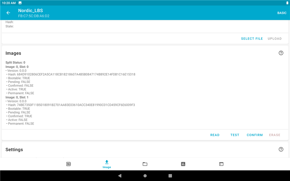

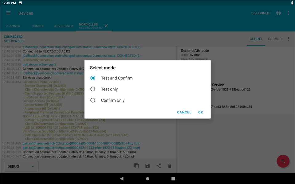

V	10:19:25.226	[j] Starting DFU, mode: TEST_AND_CONFIRM
I	10:19:25.377	[e] Connection parameters updated (interval: 15.0ms, latency: 0, timeout: 5000ms)
I	10:19:25.403	[e] Sending (10 bytes) Header (Op: 0, Flags: 0, Len: 2, Group: 1, Seq: 176, Command: 0) CBOR {}
I	10:19:25.440	[e] Data written to da2e7828-fbce-4e01-ae9e-261174997c48
I	10:19:25.478	[e] Notification received from da2e7828-fbce-4e01-ae9e-261174997c48, value: (0x) 01-00-00-F4-00-01-B0-00-BF-66-69-6D-61-67-65-73-9F-BF-64-73-6C-6F-74-00-67-76-65-72-73-69-6F-6E-65-30-2E-30-2E-30-64-68-61-73-68-58-20-74-BE-73-50-F1-1B-50-18-09-1B-27-01-AA-83-E0-36-10-AC-C3-40-E8-19-90-C0-1C-D4-59-CF-6E-60-09-F3-68-62-6F-6F-74-61-62-6C-65-F5-67-70-65-6E-64-69-6E-67-F4-69-63-6F-6E-66-69-72-6D-65-64-F5-66-61-63-74-69-76-65-F5-69-70-65-72-6D-61-6E-65-6E-74-F4-FF-BF-64-73-6C-6F-74-01-67-76-65-72-73-69-6F-6E-65-30-2E-30-2E-30-64-68-61-73-68-58-20-68-4D-91-02-80-6C-EF-2A-5C-A1-18-CB-18-21-86-07-A4-B5-B0-84-71-74-B8-92-E1-4F-DB-1C-16-E1-53-18-68-62-6F-6F-74-61-62-6C-65-F5-67-70-65-6E-64-69-6E-67-F4-69-63-6F-6E-66-69-72-6D-65-64-F4-66-61-63-74-69-76-65-F4-69-70-65-72-6D-61-6E-65-6E-74-F4-FF-FF-6B-73-70-6C-69-74-53-74-61-74-75
I	10:19:25.497	[e] Notification received from da2e7828-fbce-4e01-ae9e-261174997c48, value: (0x) 73-00-FF
I	10:19:25.523	[e] Received Header (Op: 1, Flags: 0, Len: 244, Group: 1, Seq: 176, Command: 0) CBOR {"images":[{"slot":0,"version":"0.0.0","hash":"dL5zUPEbUBgJGycBqoPgNhCsw0DoGZDAHNRZz25gCfM=","bootable":true,"pending":false,"confirmed":true,"active":true,"permanent":false},{"slot":1,"version":"0.0.0","hash":"aE2RAoBs7ypcoRjLGCGGB6S1sIRxdLiS4U/bHBbhUxg=","bootable":true,"pending":false,"confirmed":false,"active":false,"permanent":false}],"splitStatus":0}
V	10:19:25.551	[k] Validation response: {"images":[{"slot":0,"version":"0.0.0","hash":"dL5zUPEbUBgJGycBqoPgNhCsw0DoGZDAHNRZz25gCfM=","bootable":true,"pending":false,"confirmed":true,"active":true,"permanent":false},{"slot":1,"version":"0.0.0","hash":"aE2RAoBs7ypcoRjLGCGGB6S1sIRxdLiS4U/bHBbhUxg=","bootable":true,"pending":false,"confirmed":false,"active":false,"permanent":false}],"splitStatus":0}
V	10:19:25.578	[j] Moving from state VALIDATE to state TEST
I	10:19:25.611	[e] Sending (58 bytes) Header (Op: 2, Flags: 0, Len: 50, Group: 1, Seq: 177, Command: 0) CBOR {"confirm":false,"hash":"aE2RAoBs7ypcoRjLGCGGB6S1sIRxdLiS4U/bHBbhUxg="}
I	10:19:25.632	[e] Data written to da2e7828-fbce-4e01-ae9e-261174997c48
I	10:19:25.673	[e] Notification received from da2e7828-fbce-4e01-ae9e-261174997c48, value: (0x) 03-00-00-F4-00-01-B1-00-BF-66-69-6D-61-67-65-73-9F-BF-64-73-6C-6F-74-00-67-76-65-72-73-69-6F-6E-65-30-2E-30-2E-30-64-68-61-73-68-58-20-74-BE-73-50-F1-1B-50-18-09-1B-27-01-AA-83-E0-36-10-AC-C3-40-E8-19-90-C0-1C-D4-59-CF-6E-60-09-F3-68-62-6F-6F-74-61-62-6C-65-F5-67-70-65-6E-64-69-6E-67-F4-69-63-6F-6E-66-69-72-6D-65-64-F5-66-61-63-74-69-76-65-F5-69-70-65-72-6D-61-6E-65-6E-74-F4-FF-BF-64-73-6C-6F-74-01-67-76-65-72-73-69-6F-6E-65-30-2E-30-2E-30-64-68-61-73-68-58-20-68-4D-91-02-80-6C-EF-2A-5C-A1-18-CB-18-21-86-07-A4-B5-B0-84-71-74-B8-92-E1-4F-DB-1C-16-E1-53-18-68-62-6F-6F-74-61-62-6C-65-F5-67-70-65-6E-64-69-6E-67-F5-69-63-6F-6E-66-69-72-6D-65-64-F4-66-61-63-74-69-76-65-F4-69-70-65-72-6D-61-6E-65-6E-74-F4-FF-FF-6B-73-70-6C-69-74-53-74-61-74-75
I	10:19:25.701	[e] Notification received from da2e7828-fbce-4e01-ae9e-261174997c48, value: (0x) 73-00-FF
I	10:19:25.723	[e] Received Header (Op: 3, Flags: 0, Len: 244, Group: 1, Seq: 177, Command: 0) CBOR {"images":[{"slot":0,"version":"0.0.0","hash":"dL5zUPEbUBgJGycBqoPgNhCsw0DoGZDAHNRZz25gCfM=","bootable":true,"pending":false,"confirmed":true,"active":true,"permanent":false},{"slot":1,"version":"0.0.0","hash":"aE2RAoBs7ypcoRjLGCGGB6S1sIRxdLiS4U/bHBbhUxg=","bootable":true,"pending":true,"confirmed":false,"active":false,"permanent":false}],"splitStatus":0}
V	10:19:25.747	[i] Test response: {"images":[{"slot":0,"version":"0.0.0","hash":"dL5zUPEbUBgJGycBqoPgNhCsw0DoGZDAHNRZz25gCfM=","bootable":true,"pending":false,"confirmed":true,"active":true,"permanent":false},{"slot":1,"version":"0.0.0","hash":"aE2RAoBs7ypcoRjLGCGGB6S1sIRxdLiS4U/bHBbhUxg=","bootable":true,"pending":true,"confirmed":false,"active":false,"permanent":false}],"splitStatus":0}
V	10:19:25.770	[j] Moving from state TEST to state RESET
I	10:19:25.807	[e] Sending (10 bytes) Header (Op: 2, Flags: 0, Len: 2, Group: 0, Seq: 178, Command: 5) CBOR {}
I	10:19:25.847	[e] Data written to da2e7828-fbce-4e01-ae9e-261174997c48
I	10:19:25.876	[e] Notification received from da2e7828-fbce-4e01-ae9e-261174997c48, value: (0x) 03-00-00-02-00-00-B2-05-BF-FF
I	10:19:25.896	[e] Received Header (Op: 3, Flags: 0, Len: 2, Group: 0, Seq: 178, Command: 5) CBOR {}
V	10:19:25.917	[g] Reset request success. Waiting for disconnect...

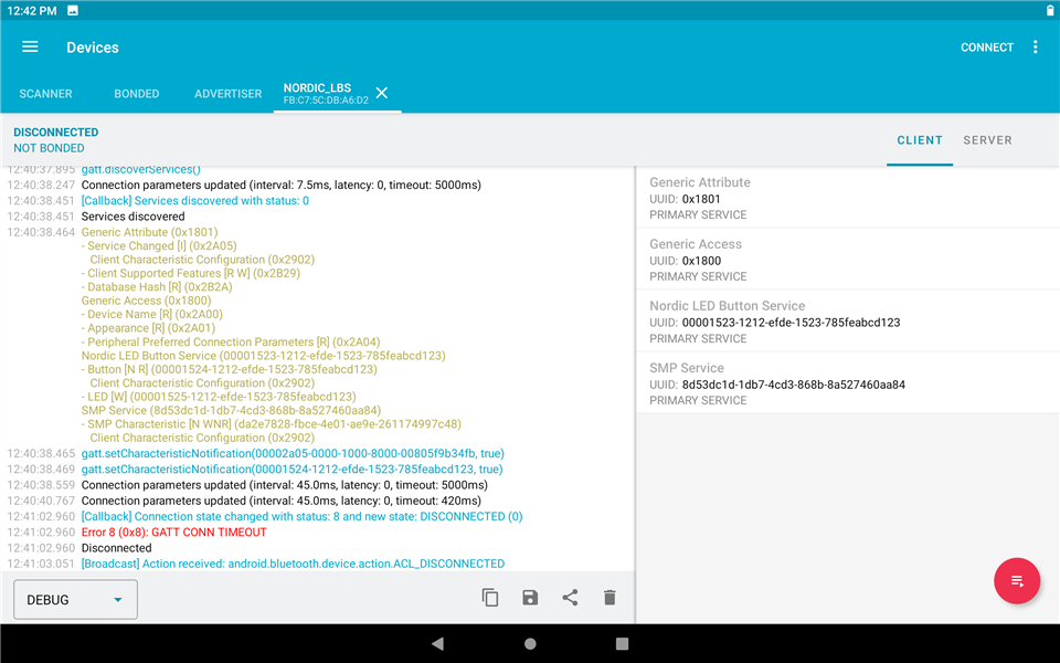

W	10:19:33.614	[e] Error: (0x8): GATT CONN TIMEOUT
I	10:19:33.666	[e] Disconnected
I	10:19:33.701	[g] Device disconnected
V	10:19:33.727	[g] Waiting remaining 2192 ms for the swap operation to complete
V	10:19:35.957	[j] Moving from state RESET to state CONFIRM
I	10:19:47.473	[e] Connected to FB:C7:5C:DB:A6:D2
I	10:19:47.896	[e] Connection parameters updated (interval: 7.5ms, latency: 0, timeout: 5000ms)
I	10:19:47.974	[e] PHY updated (TX: LE 2M, RX: LE 2M)
I	10:19:48.210	[e] Services discovered
I	10:19:48.262	[e] MTU changed to: 252
I	10:19:48.300	[e] Connection parameters updated (interval: 45.0ms, latency: 0, timeout: 5000ms)
I	10:19:48.529	[e] Data written to descr. 00002902-0000-1000-8000-00805f9b34fb
I	10:19:48.572	[e] Notifications enabled
I	10:19:48.606	[e] Data written to da2e7828-fbce-4e01-ae9e-261174997c48
I	10:19:48.661	[e] Notification received from da2e7828-fbce-4e01-ae9e-261174997c48, value: (0x) 01-00-00-06-00-00-FF-06-BF-62-72-63-08-FF
I	10:19:48.690	[e] Wait for value changed complete
I	10:19:48.717	[e] Received Header (Op: 1, Flags: 0, Len: 6, Group: 0, Seq: 255, Command: 6) CBOR {"rc":8}
I	10:19:48.744	[e] PHY read (TX: LE 2M, RX: LE 2M)

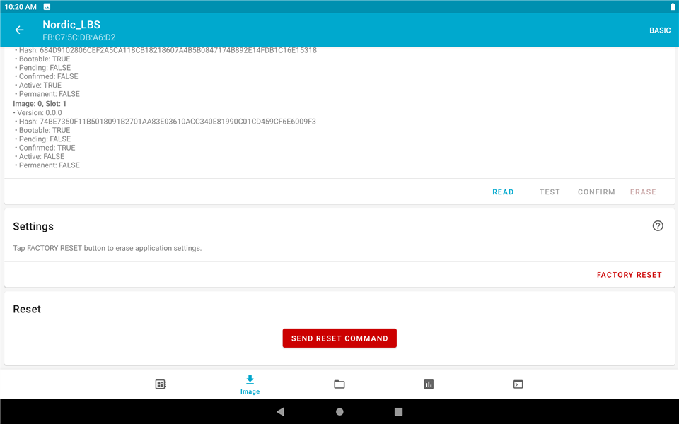

I	10:19:48.774	[e] Sending (58 bytes) Header (Op: 2, Flags: 0, Len: 50, Group: 1, Seq: 0, Command: 0) CBOR {"confirm":true,"hash":"aE2RAoBs7ypcoRjLGCGGB6S1sIRxdLiS4U/bHBbhUxg="}
I	10:19:48.802	[e] Sending (10 bytes) Header (Op: 0, Flags: 0, Len: 2, Group: 0, Seq: 1, Command: 6) CBOR {}
I	10:19:48.826	[e] Data written to da2e7828-fbce-4e01-ae9e-261174997c48
I	10:19:48.861	[e] Data written to da2e7828-fbce-4e01-ae9e-261174997c48
I	10:19:48.891	[e] Notification received from da2e7828-fbce-4e01-ae9e-261174997c48, value: (0x) 03-00-00-06-00-01-00-00-BF-62-72-63-03-FF
I	10:19:48.921	[e] Received Header (Op: 3, Flags: 0, Len: 6, Group: 1, Seq: 0, Command: 0) CBOR {"rc":3}
E	10:19:48.968	Upgrade failed
I	10:19:49.002	[e] Notification received from da2e7828-fbce-4e01-ae9e-261174997c48, value: (0x) 01-00-00-06-00-00-01-06-BF-62-72-63-08-FF
I	10:19:49.036	[e] Received Header (Op: 1, Flags: 0, Len: 6, Group: 0, Seq: 1, Command: 6) CBOR {"rc":8}

W	10:20:27.683	[e] Error: (0x8): GATT CONN TIMEOUT
I	10:20:27.725	[e] Disconnected

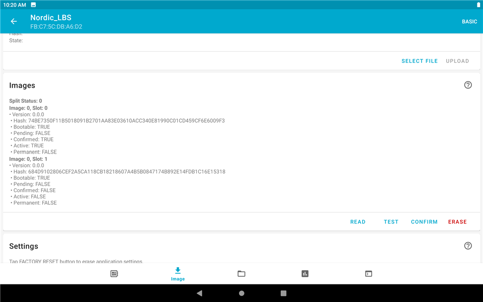

I	10:20:48.442	[e] Connected to FB:C7:5C:DB:A6:D2
I	10:20:48.872	[e] Connection parameters updated (interval: 7.5ms, latency: 0, timeout: 5000ms)
I	10:20:48.956	[e] PHY updated (TX: LE 2M, RX: LE 2M)
I	10:20:49.167	[e] Services discovered
I	10:20:49.223	[e] MTU changed to: 252
I	10:20:49.278	[e] Connection parameters updated (interval: 45.0ms, latency: 0, timeout: 5000ms)
I	10:20:49.322	[e] Data written to descr. 00002902-0000-1000-8000-00805f9b34fb
I	10:20:49.353	[e] Notifications enabled
I	10:20:49.389	[e] Data written to da2e7828-fbce-4e01-ae9e-261174997c48
I	10:20:49.461	[e] Notification received from da2e7828-fbce-4e01-ae9e-261174997c48, value: (0x) 01-00-00-06-00-00-FF-06-BF-62-72-63-08-FF
I	10:20:49.491	[e] Wait for value changed complete
I	10:20:49.528	[e] Received Header (Op: 1, Flags: 0, Len: 6, Group: 0, Seq: 255, Command: 6) CBOR {"rc":8}
I	10:20:49.563	[e] PHY read (TX: LE 2M, RX: LE 2M)
I	10:20:49.601	[e] Sending (10 bytes) Header (Op: 0, Flags: 0, Len: 2, Group: 1, Seq: 0, Command: 0) CBOR {}
I	10:20:49.647	[e] Sending (10 bytes) Header (Op: 0, Flags: 0, Len: 2, Group: 0, Seq: 1, Command: 6) CBOR {}
I	10:20:49.674	[e] Data written to da2e7828-fbce-4e01-ae9e-261174997c48
I	10:20:49.701	[e] Data written to da2e7828-fbce-4e01-ae9e-261174997c48
I	10:20:49.748	[e] Notification received from da2e7828-fbce-4e01-ae9e-261174997c48, value: (0x) 01-00-00-F4-00-01-00-00-BF-66-69-6D-61-67-65-73-9F-BF-64-73-6C-6F-74-00-67-76-65-72-73-69-6F-6E-65-30-2E-30-2E-30-64-68-61-73-68-58-20-74-BE-73-50-F1-1B-50-18-09-1B-27-01-AA-83-E0-36-10-AC-C3-40-E8-19-90-C0-1C-D4-59-CF-6E-60-09-F3-68-62-6F-6F-74-61-62-6C-65-F5-67-70-65-6E-64-69-6E-67-F4-69-63-6F-6E-66-69-72-6D-65-64-F5-66-61-63-74-69-76-65-F5-69-70-65-72-6D-61-6E-65-6E-74-F4-FF-BF-64-73-6C-6F-74-01-67-76-65-72-73-69-6F-6E-65-30-2E-30-2E-30-64-68-61-73-68-58-20-68-4D-91-02-80-6C-EF-2A-5C-A1-18-CB-18-21-86-07-A4-B5-B0-84-71-74-B8-92-E1-4F-DB-1C-16-E1-53-18-68-62-6F-6F-74-61-62-6C-65-F5-67-70-65-6E-64-69-6E-67-F4-69-63-6F-6E-66-69-72-6D-65-64-F4-66-61-63-74-69-76-65-F4-69-70-65-72-6D-61-6E-65-6E-74-F4-FF-FF-6B-73-70-6C-69-74-53-74-61-74-75
I	10:20:49.822	[e] Notification received from da2e7828-fbce-4e01-ae9e-261174997c48, value: (0x) 73-00-FF
I	10:20:49.859	[e] Received Header (Op: 1, Flags: 0, Len: 244, Group: 1, Seq: 0, Command: 0) CBOR {"images":[{"slot":0,"version":"0.0.0","hash":"dL5zUPEbUBgJGycBqoPgNhCsw0DoGZDAHNRZz25gCfM=","bootable":true,"pending":false,"confirmed":true,"active":true,"permanent":false},{"slot":1,"version":"0.0.0","hash":"aE2RAoBs7ypcoRjLGCGGB6S1sIRxdLiS4U/bHBbhUxg=","bootable":true,"pending":false,"confirmed":false,"active":false,"permanent":false}],"splitStatus":0}
I	10:20:49.913	[e] Notification received from da2e7828-fbce-4e01-ae9e-261174997c48, value: (0x) 01-00-00-06-00-00-01-06-BF-62-72-63-08-FF
I	10:20:49.953	[e] Received Header (Op: 1, Flags: 0, Len: 6, Group: 0, Seq: 1, Command: 6) CBOR {"rc":8}
I	10:20:53.566	[e] Connection parameters updated (interval: 45.0ms, latency: 0, timeout: 420ms)

The following steps show the process we did.
1. After connect to the nRF52840DK, click "Image" section and choose "ADVANED". Then "READ" the image. It will send the current image information.
2. Choose "BASIC" and select a image file (binary or zip file). After click "START", it will ask you to select mode. Here we choose "Confirm only" and click "START".
3. After the process is completed, the "State" will change. The message is "Invalid value (3)".
4. Check the image information as the same as the first step and you will see that there are two images in nRF52840DK. But the active image is not the new one but the original one.
5. Next, test the "Test and confirm" option as the same as the second step.
6. The result is also the same as the "Confirm only" method.
7. "READ" image again and you will see the active image is changed to the new one and their locations have also changed.
8. Send a "RESET" command to nRF52840DK to test if it will use the new image after reset.
9. "READ" image again and you will see the active is changed to the original one but not the new one, since the image was not successfully confirmed.
Can anyone help with this?

    I will go with you through the code of mcumgr subsystem from where you're getting the error.
    First, have a look here: https://github.com/nrfconnect/sdk-zephyr/blob/0cd59b0c43aa0c9d6682066aca74ac05be094169/subsys/mgmt/mcumgr/grp/img_mgmt/src/img_mgmt.c#L585. This is where handlers for different commands are registered. The confirm or test commands are sent as Write to IMG_MGMT_ID_STATE command to Image group, that means we need to check img_mgmt_state_write method.:
    https://github.com/nrfconnect/sdk-zephyr/blob/0cd59b0c43aa0c9d6682066aca74ac05be094169/subsys/mgmt/mcumgr/grp/img_mgmt/src/img_mgmt_state.c#L274
    We are looking for places where an error called MGMT_ERR_EINVAL is returned as rc.
    I assume the decoding here: https://github.com/nrfconnect/sdk-zephyr/blob/0cd59b0c43aa0c9d6682066aca74ac05be094169/subsys/mgmt/mcumgr/grp/img_mgmt/src/img_mgmt_state.c#L290 works, as it is called both when you have confirm=false and confirm=true. The first case seems to be working properly. It sets the pending flag to true. After reset the device is swapping images and runs the new image, which is correct. This method fails when confirm is true, which means the error must come later.
    The hash sent is equal in both cases, so this also doesn't end here: https://github.com/nrfconnect/sdk-zephyr/blob/0cd59b0c43aa0c9d6682066aca74ac05be094169/subsys/mgmt/mcumgr/grp/img_mgmt/src/img_mgmt_state.c#L305
    Then, the next possible place is here: https://github.com/nrfconnect/sdk-zephyr/blob/0cd59b0c43aa0c9d6682066aca74ac05be094169/subsys/mgmt/mcumgr/grp/img_mgmt/src/img_mgmt_state.c#L315 where the manager is looking for the image to be confirmed. This method is defined here: https://github.com/nrfconnect/sdk-zephyr/blob/0cd59b0c43aa0c9d6682066aca74ac05be094169/subsys/mgmt/mcumgr/grp/img_mgmt/src/img_mgmt.c#L233-L247 indicating that perhaps CONFIG_IMG_MGMT_UPDATABLE_IMAGE_NUMBER isn't set properly.
    Check this out:
    https://developer.nordicsemi.com/nRF_Connect_SDK/doc/1.9.1/kconfig/CONFIG_IMG_MGMT_UPDATABLE_IMAGE_NUMBER.html#std-kconfig-CONFIG_IMG_MGMT_UPDATABLE_IMAGE_NUMBER
    If that's not the case, try going further that path. But I suspect that may be it. The next method is just returning the state of images, which is again called for test and confirm, so should work the same way.
    Hope that helped!

  • Hi, I had a talk with a firmware developer familiar with MCU manager.
    First of all we confirm that dfu works on our side. We used NCS 2.2. That may indicate an issue in your code out setup.
    Are you using external storage for the secondary slots?
    After you read the image state on Image 4 above, could you then click Confirm button instead of trying upgrade with Test & Confirm? On the Advanced screen you can upload the image and then select Confirm manually. Did you try that?
    Did you also try using nRF Connect Device Manager on iOS?
    Well... maybe there is something wrong with my code. But I followed all the procedures in the guide, even the sample code. Other than that, I didn't add or modify anything, except adding a test log to the test image.
    I'm not sure if I use the secondary slots for external storage. As mentioned above, I followed all the steps in the guide and didn't change anything except the test logs. Or maybe I missed somewhere.
    In addition, I also suspect that another possible place is the device tree setting. The DTS of nRF52840DK in NCS v.2.2.0 is here: nrf52840dk_nrf52840.dts.
    The screenshot below shows the result of my following your advice.
    Device Manager, 2023-03-01
    I	14:46:40.842	[e] Connected to FB:C7:5C:DB:A6:D2
    I	14:46:41.270	[e] Connection parameters updated (interval: 7.5ms, latency: 0, timeout: 5000ms)
    I	14:46:41.577	[e] Services discovered
    I	14:46:41.667	[e] Connection parameters updated (interval: 45.0ms, latency: 0, timeout: 5000ms)
    I	14:46:41.720	[e] MTU changed to: 252
    I	14:46:41.946	[e] Data written to descr. 00002902-0000-1000-8000-00805f9b34fb
    I	14:46:41.976	[e] Notifications enabled
    I	14:46:42.004	[e] Data written to da2e7828-fbce-4e01-ae9e-261174997c48
    I	14:46:42.078	[e] Notification received from da2e7828-fbce-4e01-ae9e-261174997c48, value: (0x) 01-00-00-06-00-00-FF-06-BF-62-72-63-08-FF
    I	14:46:42.105	[e] Wait for value changed complete
    I	14:46:42.154	[e] Received Header (Op: 1, Flags: 0, Len: 6, Group: 0, Seq: 255, Command: 6) CBOR {"rc":8}
    I	14:46:42.178	[e] PHY read (TX: LE 2M, RX: LE 2M)
    I	14:46:42.205	[e] Sending (10 bytes) Header (Op: 0, Flags: 0, Len: 2, Group: 1, Seq: 0, Command: 0) CBOR {}
    I	14:46:42.240	[e] Sending (10 bytes) Header (Op: 0, Flags: 0, Len: 2, Group: 0, Seq: 1, Command: 6) CBOR {}
    I	14:46:42.259	[e] Data written to da2e7828-fbce-4e01-ae9e-261174997c48
    I	14:46:42.288	[e] Data written to da2e7828-fbce-4e01-ae9e-261174997c48
    I	14:46:42.437	[e] Notification received from da2e7828-fbce-4e01-ae9e-261174997c48, value: (0x) 01-00-00-86-00-01-00-00-BF-66-69-6D-61-67-65-73-9F-BF-64-73-6C-6F-74-00-67-76-65-72-73-69-6F-6E-65-30-2E-30-2E-30-64-68-61-73-68-58-20-1D-63-C4-57-13-B3-06-10-AD-EB-52-EF-E1-4B-9C-8B-D0-AB-49-CF-BA-02-ED-69-4F-16-AC-02-96-D5-D2-E5-68-62-6F-6F-74-61-62-6C-65-F5-67-70-65-6E-64-69-6E-67-F4-69-63-6F-6E-66-69-72-6D-65-64-F5-66-61-63-74-69-76-65-F5-69-70-65-72-6D-61-6E-65-6E-74-F4-FF-FF-6B-73-70-6C-69-74-53-74-61-74-75-73-00-FF
    I	14:46:42.460	[e] Received Header (Op: 1, Flags: 0, Len: 134, Group: 1, Seq: 0, Command: 0) CBOR {"images":[{"slot":0,"version":"0.0.0","hash":"HWPEVxOzBhCt61Lv4Uuci9CrSc+6Au1pTxasApbV0uU=","bootable":true,"pending":false,"confirmed":true,"active":true,"permanent":false}],"splitStatus":0}
    I	14:46:42.525	[e] Notification received from da2e7828-fbce-4e01-ae9e-261174997c48, value: (0x) 01-00-00-06-00-00-01-06-BF-62-72-63-08-FF
    I	14:46:42.551	[e] Received Header (Op: 1, Flags: 0, Len: 6, Group: 0, Seq: 1, Command: 6) CBOR {"rc":8}
    I	14:46:45.595	[e] Connection parameters updated (interval: 45.0ms, latency: 0, timeout: 420ms)
    I	14:48:32.174	[e] Sending (10 bytes) Header (Op: 0, Flags: 0, Len: 2, Group: 1, Seq: 2, Command: 0) CBOR {}
    I	14:48:32.200	[e] Data written to da2e7828-fbce-4e01-ae9e-261174997c48
    I	14:48:32.284	[e] Notification received from da2e7828-fbce-4e01-ae9e-261174997c48, value: (0x) 01-00-00-86-00-01-02-00-BF-66-69-6D-61-67-65-73-9F-BF-64-73-6C-6F-74-00-67-76-65-72-73-69-6F-6E-65-30-2E-30-2E-30-64-68-61-73-68-58-20-1D-63-C4-57-13-B3-06-10-AD-EB-52-EF-E1-4B-9C-8B-D0-AB-49-CF-BA-02-ED-69-4F-16-AC-02-96-D5-D2-E5-68-62-6F-6F-74-61-62-6C-65-F5-67-70-65-6E-64-69-6E-67-F4-69-63-6F-6E-66-69-72-6D-65-64-F5-66-61-63-74-69-76-65-F5-69-70-65-72-6D-61-6E-65-6E-74-F4-FF-FF-6B-73-70-6C-69-74-53-74-61-74-75-73-00-FF
    I	14:48:32.312	[e] Received Header (Op: 1, Flags: 0, Len: 134, Group: 1, Seq: 2, Command: 0) CBOR {"images":[{"slot":0,"version":"0.0.0","hash":"HWPEVxOzBhCt61Lv4Uuci9CrSc+6Au1pTxasApbV0uU=","bootable":true,"pending":false,"confirmed":true,"active":true,"permanent":false}],"splitStatus":0}
    I	14:49:30.779	[e] Sending (10 bytes) Header (Op: 0, Flags: 0, Len: 2, Group: 1, Seq: 177, Command: 0) CBOR {}
    I	14:49:30.819	[e] Data written to da2e7828-fbce-4e01-ae9e-261174997c48
    I	14:49:30.873	[e] Notification received from da2e7828-fbce-4e01-ae9e-261174997c48, value: (0x) 01-00-00-F4-00-01-B1-00-BF-66-69-6D-61-67-65-73-9F-BF-64-73-6C-6F-74-00-67-76-65-72-73-69-6F-6E-65-30-2E-30-2E-30-64-68-61-73-68-58-20-1D-63-C4-57-13-B3-06-10-AD-EB-52-EF-E1-4B-9C-8B-D0-AB-49-CF-BA-02-ED-69-4F-16-AC-02-96-D5-D2-E5-68-62-6F-6F-74-61-62-6C-65-F5-67-70-65-6E-64-69-6E-67-F4-69-63-6F-6E-66-69-72-6D-65-64-F5-66-61-63-74-69-76-65-F5-69-70-65-72-6D-61-6E-65-6E-74-F4-FF-BF-64-73-6C-6F-74-01-67-76-65-72-73-69-6F-6E-65-30-2E-30-2E-30-64-68-61-73-68-58-20-6D-FE-5C-B1-3B-F2-10-F3-22-2C-64-C5-71-10-A0-8B-6A-1F-46-7E-D4-C6-37-C8-BF-0B-02-F9-7F-0F-D6-E3-68-62-6F-6F-74-61-62-6C-65-F5-67-70-65-6E-64-69-6E-67-F4-69-63-6F-6E-66-69-72-6D-65-64-F4-66-61-63-74-69-76-65-F4-69-70-65-72-6D-61-6E-65-6E-74-F4-FF-FF-6B-73-70-6C-69-74-53-74-61-74-75
    I	14:49:30.918	[e] Notification received from da2e7828-fbce-4e01-ae9e-261174997c48, value: (0x) 73-00-FF
    I	14:49:30.952	[e] Received Header (Op: 1, Flags: 0, Len: 244, Group: 1, Seq: 177, Command: 0) CBOR {"images":[{"slot":0,"version":"0.0.0","hash":"HWPEVxOzBhCt61Lv4Uuci9CrSc+6Au1pTxasApbV0uU=","bootable":true,"pending":false,"confirmed":true,"active":true,"permanent":false},{"slot":1,"version":"0.0.0","hash":"bf5csTvyEPMiLGTFcRCgi2ofRn7UxjfIvwsC+X8P1uM=","bootable":true,"pending":false,"confirmed":false,"active":false,"permanent":false}],"splitStatus":0}
    I	14:49:44.524	[e] Sending (58 bytes) Header (Op: 2, Flags: 0, Len: 50, Group: 1, Seq: 178, Command: 0) CBOR {"confirm":true,"hash":"bf5csTvyEPMiLGTFcRCgi2ofRn7UxjfIvwsC+X8P1uM="}
    I	14:49:44.561	[e] Data written to da2e7828-fbce-4e01-ae9e-261174997c48
    I	14:49:44.584	[e] Notification received from da2e7828-fbce-4e01-ae9e-261174997c48, value: (0x) 03-00-00-06-00-01-B2-00-BF-62-72-63-03-FF
    I	14:49:44.607	[e] Received Header (Op: 3, Flags: 0, Len: 6, Group: 1, Seq: 178, Command: 0) CBOR {"rc":3}
    I	14:50:55.508	[e] Sending (10 bytes) Header (Op: 0, Flags: 0, Len: 2, Group: 1, Seq: 179, Command: 0) CBOR {}
    I	14:50:55.554	[e] Data written to da2e7828-fbce-4e01-ae9e-261174997c48
    I	14:50:55.584	[e] Notification received from da2e7828-fbce-4e01-ae9e-261174997c48, value: (0x) 01-00-00-F4-00-01-B3-00-BF-66-69-6D-61-67-65-73-9F-BF-64-73-6C-6F-74-00-67-76-65-72-73-69-6F-6E-65-30-2E-30-2E-30-64-68-61-73-68-58-20-1D-63-C4-57-13-B3-06-10-AD-EB-52-EF-E1-4B-9C-8B-D0-AB-49-CF-BA-02-ED-69-4F-16-AC-02-96-D5-D2-E5-68-62-6F-6F-74-61-62-6C-65-F5-67-70-65-6E-64-69-6E-67-F4-69-63-6F-6E-66-69-72-6D-65-64-F5-66-61-63-74-69-76-65-F5-69-70-65-72-6D-61-6E-65-6E-74-F4-FF-BF-64-73-6C-6F-74-01-67-76-65-72-73-69-6F-6E-65-30-2E-30-2E-30-64-68-61-73-68-58-20-6D-FE-5C-B1-3B-F2-10-F3-22-2C-64-C5-71-10-A0-8B-6A-1F-46-7E-D4-C6-37-C8-BF-0B-02-F9-7F-0F-D6-E3-68-62-6F-6F-74-61-62-6C-65-F5-67-70-65-6E-64-69-6E-67-F4-69-63-6F-6E-66-69-72-6D-65-64-F4-66-61-63-74-69-76-65-F4-69-70-65-72-6D-61-6E-65-6E-74-F4-FF-FF-6B-73-70-6C-69-74-53-74-61-74-75
    I	14:50:55.610	[e] Notification received from da2e7828-fbce-4e01-ae9e-261174997c48, value: (0x) 73-00-FF
    I	14:50:55.645	[e] Received Header (Op: 1, Flags: 0, Len: 244, Group: 1, Seq: 179, Command: 0) CBOR {"images":[{"slot":0,"version":"0.0.0","hash":"HWPEVxOzBhCt61Lv4Uuci9CrSc+6Au1pTxasApbV0uU=","bootable":true,"pending":false,"confirmed":true,"active":true,"permanent":false},{"slot":1,"version":"0.0.0","hash":"bf5csTvyEPMiLGTFcRCgi2ofRn7UxjfIvwsC+X8P1uM=","bootable":true,"pending":false,"confirmed":false,"active":false,"permanent":false}],"splitStatus":0}
    I	14:51:04.115	[e] Sending (58 bytes) Header (Op: 2, Flags: 0, Len: 50, Group: 1, Seq: 180, Command: 0) CBOR {"confirm":false,"hash":"bf5csTvyEPMiLGTFcRCgi2ofRn7UxjfIvwsC+X8P1uM="}
    I	14:51:04.156	[e] Data written to da2e7828-fbce-4e01-ae9e-261174997c48
    I	14:51:04.192	[e] Notification received from da2e7828-fbce-4e01-ae9e-261174997c48, value: (0x) 03-00-00-F4-00-01-B4-00-BF-66-69-6D-61-67-65-73-9F-BF-64-73-6C-6F-74-00-67-76-65-72-73-69-6F-6E-65-30-2E-30-2E-30-64-68-61-73-68-58-20-1D-63-C4-57-13-B3-06-10-AD-EB-52-EF-E1-4B-9C-8B-D0-AB-49-CF-BA-02-ED-69-4F-16-AC-02-96-D5-D2-E5-68-62-6F-6F-74-61-62-6C-65-F5-67-70-65-6E-64-69-6E-67-F4-69-63-6F-6E-66-69-72-6D-65-64-F5-66-61-63-74-69-76-65-F5-69-70-65-72-6D-61-6E-65-6E-74-F4-FF-BF-64-73-6C-6F-74-01-67-76-65-72-73-69-6F-6E-65-30-2E-30-2E-30-64-68-61-73-68-58-20-6D-FE-5C-B1-3B-F2-10-F3-22-2C-64-C5-71-10-A0-8B-6A-1F-46-7E-D4-C6-37-C8-BF-0B-02-F9-7F-0F-D6-E3-68-62-6F-6F-74-61-62-6C-65-F5-67-70-65-6E-64-69-6E-67-F5-69-63-6F-6E-66-69-72-6D-65-64-F4-66-61-63-74-69-76-65-F4-69-70-65-72-6D-61-6E-65-6E-74-F4-FF-FF-6B-73-70-6C-69-74-53-74-61-74-75
    I	14:51:04.218	[e] Notification received from da2e7828-fbce-4e01-ae9e-261174997c48, value: (0x) 73-00-FF
    I	14:51:04.244	[e] Received Header (Op: 3, Flags: 0, Len: 244, Group: 1, Seq: 180, Command: 0) CBOR {"images":[{"slot":0,"version":"0.0.0","hash":"HWPEVxOzBhCt61Lv4Uuci9CrSc+6Au1pTxasApbV0uU=","bootable":true,"pending":false,"confirmed":true,"active":true,"permanent":false},{"slot":1,"version":"0.0.0","hash":"bf5csTvyEPMiLGTFcRCgi2ofRn7UxjfIvwsC+X8P1uM=","bootable":true,"pending":true,"confirmed":false,"active":false,"permanent":false}],"splitStatus":0}
    I	14:51:31.493	[e] Sending (10 bytes) Header (Op: 2, Flags: 0, Len: 2, Group: 0, Seq: 181, Command: 5) CBOR {}
    I	14:51:31.535	[e] Data written to da2e7828-fbce-4e01-ae9e-261174997c48
    I	14:51:31.559	[e] Notification received from da2e7828-fbce-4e01-ae9e-261174997c48, value: (0x) 03-00-00-02-00-00-B5-05-BF-FF
    I	14:51:31.584	[e] Received Header (Op: 3, Flags: 0, Len: 2, Group: 0, Seq: 181, Command: 5) CBOR {}
    W	14:51:39.305	[e] Error: (0x8): GATT CONN TIMEOUT
    I	14:51:39.356	[e] Disconnected
    I	14:51:53.050	[e] Connected to FB:C7:5C:DB:A6:D2
    I	14:51:53.474	[e] Connection parameters updated (interval: 7.5ms, latency: 0, timeout: 5000ms)
    I	14:51:53.555	[e] PHY updated (TX: LE 2M, RX: LE 2M)
    I	14:51:53.784	[e] Services discovered
    I	14:51:53.845	[e] MTU changed to: 252
    I	14:51:53.874	[e] Connection parameters updated (interval: 45.0ms, latency: 0, timeout: 5000ms)
    I	14:51:53.922	[e] Data written to descr. 00002902-0000-1000-8000-00805f9b34fb
    I	14:51:53.937	[e] Notifications enabled
    I	14:51:53.956	[e] Data written to da2e7828-fbce-4e01-ae9e-261174997c48
    I	14:51:54.064	[e] Notification received from da2e7828-fbce-4e01-ae9e-261174997c48, value: (0x) 01-00-00-06-00-00-FF-06-BF-62-72-63-08-FF
    I	14:51:54.091	[e] Wait for value changed complete
    I	14:51:54.133	[e] Received Header (Op: 1, Flags: 0, Len: 6, Group: 0, Seq: 255, Command: 6) CBOR {"rc":8}
    I	14:51:54.160	[e] PHY read (TX: LE 2M, RX: LE 2M)
    I	14:51:54.195	[e] Sending (10 bytes) Header (Op: 0, Flags: 0, Len: 2, Group: 1, Seq: 0, Command: 0) CBOR {}
    I	14:51:54.239	[e] Sending (10 bytes) Header (Op: 0, Flags: 0, Len: 2, Group: 0, Seq: 1, Command: 6) CBOR {}
    I	14:51:54.263	[e] Data written to da2e7828-fbce-4e01-ae9e-261174997c48
    I	14:51:54.295	[e] Data written to da2e7828-fbce-4e01-ae9e-261174997c48
    I	14:51:54.337	[e] Notification received from da2e7828-fbce-4e01-ae9e-261174997c48, value: (0x) 01-00-00-F4-00-01-00-00-BF-66-69-6D-61-67-65-73-9F-BF-64-73-6C-6F-74-00-67-76-65-72-73-69-6F-6E-65-30-2E-30-2E-30-64-68-61-73-68-58-20-6D-FE-5C-B1-3B-F2-10-F3-22-2C-64-C5-71-10-A0-8B-6A-1F-46-7E-D4-C6-37-C8-BF-0B-02-F9-7F-0F-D6-E3-68-62-6F-6F-74-61-62-6C-65-F5-67-70-65-6E-64-69-6E-67-F4-69-63-6F-6E-66-69-72-6D-65-64-F4-66-61-63-74-69-76-65-F5-69-70-65-72-6D-61-6E-65-6E-74-F4-FF-BF-64-73-6C-6F-74-01-67-76-65-72-73-69-6F-6E-65-30-2E-30-2E-30-64-68-61-73-68-58-20-1D-63-C4-57-13-B3-06-10-AD-EB-52-EF-E1-4B-9C-8B-D0-AB-49-CF-BA-02-ED-69-4F-16-AC-02-96-D5-D2-E5-68-62-6F-6F-74-61-62-6C-65-F5-67-70-65-6E-64-69-6E-67-F4-69-63-6F-6E-66-69-72-6D-65-64-F5-66-61-63-74-69-76-65-F4-69-70-65-72-6D-61-6E-65-6E-74-F4-FF-FF-6B-73-70-6C-69-74-53-74-61-74-75
    I	14:51:54.469	[e] Notification received from da2e7828-fbce-4e01-ae9e-261174997c48, value: (0x) 73-00-FF
    I	14:51:54.502	[e] Received Header (Op: 1, Flags: 0, Len: 244, Group: 1, Seq: 0, Command: 0) CBOR {"images":[{"slot":0,"version":"0.0.0","hash":"bf5csTvyEPMiLGTFcRCgi2ofRn7UxjfIvwsC+X8P1uM=","bootable":true,"pending":false,"confirmed":false,"active":true,"permanent":false},{"slot":1,"version":"0.0.0","hash":"HWPEVxOzBhCt61Lv4Uuci9CrSc+6Au1pTxasApbV0uU=","bootable":true,"pending":false,"confirmed":true,"active":false,"permanent":false}],"splitStatus":0}
    I	14:51:54.649	[e] Notification received from da2e7828-fbce-4e01-ae9e-261174997c48, value: (0x) 01-00-00-06-00-00-01-06-BF-62-72-63-08-FF
    I	14:51:54.668	[e] Received Header (Op: 1, Flags: 0, Len: 6, Group: 0, Seq: 1, Command: 6) CBOR {"rc":8}
    I	14:51:58.167	[e] Connection parameters updated (interval: 45.0ms, latency: 0, timeout: 420ms)
    I	14:52:15.142	[e] Sending (10 bytes) Header (Op: 2, Flags: 0, Len: 2, Group: 0, Seq: 2, Command: 5) CBOR {}
    I	14:52:15.185	[e] Data written to da2e7828-fbce-4e01-ae9e-261174997c48
    I	14:52:15.303	[e] Notification received from da2e7828-fbce-4e01-ae9e-261174997c48, value: (0x) 03-00-00-02-00-00-02-05-BF-FF
    I	14:52:15.337	[e] Received Header (Op: 3, Flags: 0, Len: 2, Group: 0, Seq: 2, Command: 5) CBOR {}
    W	14:52:16.083	[e] Error: (0x8): GATT CONN TIMEOUT
    I	14:52:16.123	[e] Disconnected
    I	14:52:36.790	[e] Connected to FB:C7:5C:DB:A6:D2
    I	14:52:37.220	[e] Connection parameters updated (interval: 7.5ms, latency: 0, timeout: 5000ms)
    I	14:52:37.295	[e] PHY updated (TX: LE 2M, RX: LE 2M)
    I	14:52:37.543	[e] Services discovered
    I	14:52:37.595	[e] MTU changed to: 252
    I	14:52:37.615	[e] Connection parameters updated (interval: 45.0ms, latency: 0, timeout: 5000ms)
    I	14:52:37.802	[e] Data written to descr. 00002902-0000-1000-8000-00805f9b34fb
    I	14:52:37.834	[e] Notifications enabled
    I	14:52:37.874	[e] Data written to da2e7828-fbce-4e01-ae9e-261174997c48
    I	14:52:37.938	[e] Notification received from da2e7828-fbce-4e01-ae9e-261174997c48, value: (0x) 01-00-00-06-00-00-FF-06-BF-62-72-63-08-FF
    I	14:52:37.969	[e] Wait for value changed complete
    I	14:52:38.008	[e] Received Header (Op: 1, Flags: 0, Len: 6, Group: 0, Seq: 255, Command: 6) CBOR {"rc":8}
    I	14:52:38.033	[e] PHY read (TX: LE 2M, RX: LE 2M)
    I	14:52:38.067	[e] Sending (10 bytes) Header (Op: 0, Flags: 0, Len: 2, Group: 1, Seq: 0, Command: 0) CBOR {}
    I	14:52:38.118	[e] Data written to da2e7828-fbce-4e01-ae9e-261174997c48
    I	14:52:38.136	[e] Sending (10 bytes) Header (Op: 0, Flags: 0, Len: 2, Group: 0, Seq: 1, Command: 6) CBOR {}
    I	14:52:38.158	[e] Data written to da2e7828-fbce-4e01-ae9e-261174997c48
    I	14:52:38.214	[e] Notification received from da2e7828-fbce-4e01-ae9e-261174997c48, value: (0x) 01-00-00-F4-00-01-00-00-BF-66-69-6D-61-67-65-73-9F-BF-64-73-6C-6F-74-00-67-76-65-72-73-69-6F-6E-65-30-2E-30-2E-30-64-68-61-73-68-58-20-1D-63-C4-57-13-B3-06-10-AD-EB-52-EF-E1-4B-9C-8B-D0-AB-49-CF-BA-02-ED-69-4F-16-AC-02-96-D5-D2-E5-68-62-6F-6F-74-61-62-6C-65-F5-67-70-65-6E-64-69-6E-67-F4-69-63-6F-6E-66-69-72-6D-65-64-F5-66-61-63-74-69-76-65-F5-69-70-65-72-6D-61-6E-65-6E-74-F4-FF-BF-64-73-6C-6F-74-01-67-76-65-72-73-69-6F-6E-65-30-2E-30-2E-30-64-68-61-73-68-58-20-6D-FE-5C-B1-3B-F2-10-F3-22-2C-64-C5-71-10-A0-8B-6A-1F-46-7E-D4-C6-37-C8-BF-0B-02-F9-7F-0F-D6-E3-68-62-6F-6F-74-61-62-6C-65-F5-67-70-65-6E-64-69-6E-67-F4-69-63-6F-6E-66-69-72-6D-65-64-F4-66-61-63-74-69-76-65-F4-69-70-65-72-6D-61-6E-65-6E-74-F4-FF-FF-6B-73-70-6C-69-74-53-74-61-74-75
    I	14:52:38.299	[e] Notification received from da2e7828-fbce-4e01-ae9e-261174997c48, value: (0x) 73-00-FF
    I	14:52:38.331	[e] Received Header (Op: 1, Flags: 0, Len: 244, Group: 1, Seq: 0, Command: 0) CBOR {"images":[{"slot":0,"version":"0.0.0","hash":"HWPEVxOzBhCt61Lv4Uuci9CrSc+6Au1pTxasApbV0uU=","bootable":true,"pending":false,"confirmed":true,"active":true,"permanent":false},{"slot":1,"version":"0.0.0","hash":"bf5csTvyEPMiLGTFcRCgi2ofRn7UxjfIvwsC+X8P1uM=","bootable":true,"pending":false,"confirmed":false,"active":false,"permanent":false}],"splitStatus":0}
    I	14:52:38.388	[e] Notification received from da2e7828-fbce-4e01-ae9e-261174997c48, value: (0x) 01-00-00-06-00-00-01-06-BF-62-72-63-08-FF
    I	14:52:38.420	[e] Received Header (Op: 1, Flags: 0, Len: 6, Group: 0, Seq: 1, Command: 6) CBOR {"rc":8}
    I	14:52:41.905	[e] Connection parameters updated (interval: 45.0ms, latency: 0, timeout: 420ms)

    1. First, "READ" the image on the Advanced screen after connecting to the nRF52840DK.
    2. In "Firmware Upload" section, upload a image named "app_update.bin" and choose "Application Core".
    3. The upload process.
    4. The State will show "UPLOAD COMPLETE" after the process is completed.
    5. "READ" the image again. You will see there are two images in the nRF52840DK.
    6. The result after clicking "CONFIRM" option. It will display "Invalid value (3)".
    7. Next, "TEST" the new image after "READ" the images again.

    The following results show what we tried using Device manager on iOS.
    2. In IMAGE UPGRADE section, choose a image named "dfu_application.zip" to upgrade.
    3. Choose "Confirm Only" option.
    4. Then it will display "Remote error: In Value (3)" on the State.
    5. "READ" the image and there will be two images in the nRF52840DK.
    6. Next, use "Test And Confirm" option to test.
    7. After upgrading the image, it will reset the nRF52840DK.
    8. Confirm the new image.
    9. The result is the same as "Confirm Only" option because the new image cannot be confirmed successfully.
    10. "READ" the images again. The nRF52840DK boots from the new image.
    11. "RESET" the nRF52840DK to check if it will boot from the new image next time.
    12. The current image has been inverted to the original image.
    The following results show what we tried using nRF Connect on iOS.
    Scanner On.
    Device Appearance switched from McuMgrDFU to Blinky.
    Scanner Off.
    Connected.
    Discovered Nordic LED and Button Service and SMP Service Services.
    Discovered Characteristics Blinky Button State and Blinky LED State for Service Nordic LED and Button Service.
    Discovered Characteristics SMP Characteristic for Service SMP Service.
    Discovered Client Characteristic Configuration for Characteristic Blinky Button State
    Characteristic Blinky LED State has no Descriptors.
    Discovered Client Characteristic Configuration for Characteristic SMP Characteristic
    Found valid Firmware in file:///private/var/mobile/Library/Mobile%20Documents/com~apple~CloudDocs/Downloads/dfu_application.zip for Device DFU McuMgr.
    Disconnected.
    Connected.
    Peripheral connected
    Device ready
    LIST Command Performed with Success.
    Upgrade started with 1 images using 'Confirm Only' mode
    Firmware Upgrade Started.
    State changed from none to requestMcuMgrParameters
    Device ready
    Device capabilities not supported.
    State changed from requestMcuMgrParameters to validate
    Validation response: {"splitStatus" : 0, "images" : {{"slot" : 0, "pending" : false, "permanent" : false, "confirmed" : true, "active" : true, "bootable" : true, "version" : "0.0.0", "hash" : 0x1D63C45713B30610ADEB52EFE14B9C8BD0AB49CFBA02ED694F16AC0296D5D2E5}}}
    State changed from validate to upload
    Insufficient MTU: 249.
    Request (Group: image, seq: 1) failed: Insufficient MTU: 249.)
    MTU set to 249
    No remaining chunks to be sent? chunkOffset: 207616, imageData: 207616.
    Upload finished (1 of 1)
    State changed from upload to confirm
    Confirmation response: {"rc" : In Value (3)}
    Remote error: In Value (3).
    DFU failed: Remote error: In Value (3).
    Device ready
    Validation response: {"images" : {{"confirmed" : true, "permanent" : false, "pending" : false, "hash" : 0x1D63C45713B30610ADEB52EFE14B9C8BD0AB49CFBA02ED694F16AC0296D5D2E5, "version" : "0.0.0", "slot" : 0, "active" : true, "bootable" : true}, {"version" : "0.0.0", "active" : false, "pending" : false, "bootable" : true, "slot" : 1, "permanent" : false, "hash" : 0x6DFE5CB13BF210F3222C64C57110A08B6A1F467ED4C637C8BF0B02F97F0FD6E3, "confirmed" : false}}, "splitStatus" : 0}
    Image 0 already uploaded
    Nothing to be uploaded
    Device ready
    Validation response: {"splitStatus" : 0, "images" : {{"slot" : 0, "bootable" : true, "confirmed" : true, "hash" : 0x1D63C45713B30610ADEB52EFE14B9C8BD0AB49CFBA02ED694F16AC0296D5D2E5, "pending" : false, "permanent" : false, "active" : true, "version" : "0.0.0"}, {"pending" : false, "hash" : 0x6DFE5CB13BF210F3222C64C57110A08B6A1F467ED4C637C8BF0B02F97F0FD6E3, "confirmed" : false, "active" : false, "slot" : 1, "permanent" : false, "bootable" : true, "version" : "0.0.0"}}}
    Device ready
    Validation response: {"splitStatus" : 0, "images" : {{"active" : true, "version" : "0.0.0", "confirmed" : true, "permanent" : false, "pending" : false, "hash" : 0x1D63C45713B30610ADEB52EFE14B9C8BD0AB49CFBA02ED694F16AC0296D5D2E5, "bootable" : true, "slot" : 0}, {"active" : false, "slot" : 1, "pending" : false, "version" : "0.0.0", "bootable" : true, "confirmed" : false, "permanent" : false, "hash" : 0x6DFE5CB13BF210F3222C64C57110A08B6A1F467ED4C637C8BF0B02F97F0FD6E3}}}
    1. Connect to the nRF52840DK in nRF Connect.
    2. The infrmation of the nRF52840DK.
    3. Read the image using "List" option.
    4. In DFU seciton, Select a image name "dfu_application.zip" to upgrade.
    5. The additional information in DFU section.
    6. The upgrade process.
    7. There will be an error window pop up after the process is completed. It displayed "Remote error: In Value (3)".
    Please feel free to let me know if you need anything else.
