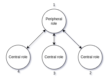

I'm trying to figure out how softdevice distributes connection intervals on multiple connections.
The test scheme for connecting devices is as follows:
Devices 2,3,4 looking for advertising from 1 and connect to it.
For simplicity, I have set the following connection options:
  • NRF_SDH_BLE_GAP_EVENT_LENGTH = 16
  • NRF_SDH_BLE_TOTAL_LINK_COUNT = 5
  • max_conn_interval = 100 ms
  • min_conn_interval = 100 ms
  • slave_latency = 0
All three devices connected with phy coded, DLE=251 bytes, MTU=247 bytes, checked the settings after connection:
  • max_rx_octets = 251
  • max_tx_octets = 251
  • max_rx_time = 2704 us
  • max_tx_time = 2704 us
Currently using NRF SDK 17.1 and s140_nrf52_7.2.0_softdevice.
I would update but don't know how yet as Nordic doesn't update the sdk anymore.
After reading the documentation, I concluded that the connection interval for device number 1 will be distributed evenly, every NRF_SDH_BLE_GAP_EVENT_LENGTH * 1.25 milliseconds.
However, in practice, I get a random distribution of intervals.
On every reboot of devices 2,3,4 I get a random position of connection intervals that are not a multiple of NRF_SDH_BLE_GAP_EVENT_LENGTH * 1.25 ms and sometimes conflict.
This is important to me for three reasons:
  1. I cannot guarantee that I will be able to send N packets per interval.
  2. Because of this, the speed drops and it becomes unpredictable.
  3. Since I will not always be able to transfer the entire packet for the connection interval, the packet transfer delay increases.
So my question is why is this happening?
Can this be managed somehow?
How does it really work?
Does this only work for when the central device has multiple connections?

  • Let me explain a little more.
    As I understand it, the central device for setting the connection interval guarantees itself a radio channel time of NRF_SDH_BLE_GAP_EVENT_LENGTH.
    Based on this image:
    I can say that the central node number 2 will skip the connection interval between 2 <-> 3 if it falls into the connection interval between 1 <-> 2 with the size NRF_SDH_BLE_GAP_EVENT_LENGTH.
    In tests, I found out that the start time of the connection interval between 2 <-> 3 will be random (connection 1 <-> 2 was already active). So there is a chance that the connection interval between 2 <-> 3 will sometimes be ignored. This is what I got in the picture two posts above, mistakenly thinking that the connection interval had increased.
    It turns out that in such a scheme, softdevice does not use transmitWindowOffset to correct the start time of the connection interval, but prefers to simply ignore the connection interval if they conflict.
    Here is an example where the connection interval between 2 <-> 3 conflicts with 1 <-> 2.
    • NRF_SDH_BLE_GAP_EVENT_LENGTH=32
    • max_conn_interval = 160 ms
    • min_conn_interval = 160 ms
    Here is an example when there is no conflict:
    Here is the behavior when I deliberately reduced the connection interval between 2 and 3:
    Now it is not clear to me why the softdevice does not correct the start time of the connection interval and how can this be fixed?
