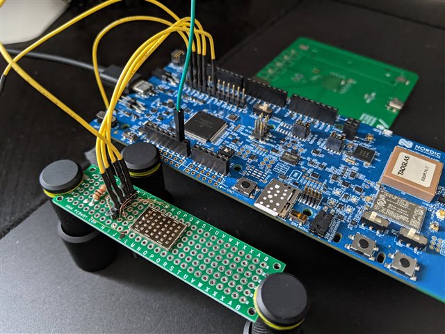

I have made a custom board with a nrf9160 and am trying to program it via the nrf9160DK. In my testing I was unable to get it to show up or program, although the programmer was set to program an external device.

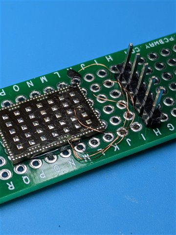

To make sure the problem is not with the soldering and missing pads on the custom board,I have a deadbug style breakout of the chip. I broke out and connected the following pins, and probed all connections to be correct. This is pictured. The custom board had decoupling as well although I could add it to this one too.
Pin 102 - VDD
Pin 101 - Enable, connected to VDD though 1k resistor
Pin 103 - Ground pad (checked continuity to all other ground pins)
Pin  34 - SWDIO
Pin  33 - SWDCLK
Pin  32 - NRST
These are all connected through jumpers to the P20 header. And the Ground on the P1 header. I have tested VDD being set to 1.8V as well as 3V. Also tried using the 5V pin on P1 as VDD.
(PGRM) -> (Board)
VDD    -> VDD
VTG    -> VDD
SWDIO  -> SWDIO
SWDCLK -> SWDCLK
RST    -> NRST
GND    -> GND

Am I missing any connections or is there any method of more diagnostic info to see why I cam not getting a connection to the external chip? Would trying to read the SWD lines provide any insight?
    The VIO pin was floating, so I connected it to VDD and nothing changed. We received the 5340DK and connecting that allowed it to work immediacy, along with the custom board. It seems like the programing chip on the 9160DK is damaged on my board. I was also able to program the chip on the old board with the 5340DK.
    Out of curiosity for the actual minimum viable connections needed for future debugging, I removed the VDD_GPIO leaving it floating. It was still able to program, although with the pin being floating and no knowledge of internal defaults, that isn't really guaranteed. I was also able to remove the nRST pin and was still able to program.
    So the minimum connections are VDD, EN, SWDIO, SWDCLK, and GND should allow you to program a chip. Thanks for the help, I think this can be closed.
