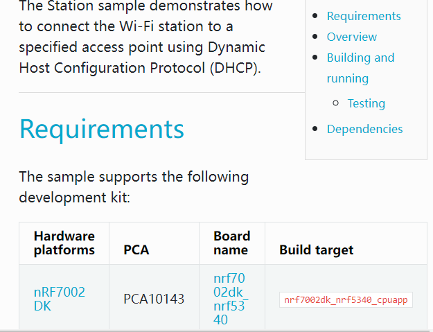

the sample only in 5340!
We support nRF5340, nRF52840 an nRF9160. You have to upgrade to ncs v2.2.99-dev3. Currently it is not possible with another MCU out of these. You can read this previous case:
