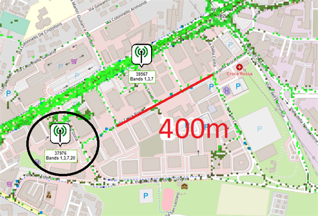

  • Hi, Marco: I'm Andrew, I work on the Location Services feature with Cole.

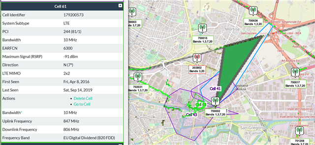

    I'd like to offer some more context to the conversation surrounding LTE positioning. First, I think there seems to be a misunderstanding about the term "cell". The term "cell" refers to a specific geographic area that is served by a specific tower, or eNodeB in LTE terminology. Let's look at an example using your original serving tower to see how multicell can improve a position estimate.
    Let's take the following request and look at its corresponding cell on CellMapper:
     	"lte": [
    			"mcc": 222,
    			"mnc": 1,
    			"tac": 17211,
    			"eci": 179200573
    Finding the corresponding cell on CellMapper means deriving the eNodeB, or tower, ID from the Cell ID. The eNodeB ID here is '700002', and the Sector (or cell) ID is '61'. This is what that cell looks like:
    The result we get from nRF Cloud for that data is here:
    	"lat": 45.4181242,
    	"lon": 11.9116044,
    	"uncertainty": 796
    Which correlates to this position:

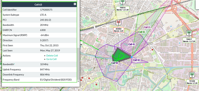

    Now, let's add another nearby cell. Adding another cell from the same eNodeB makes our request:
     	"lte": [
    			"mcc": 222,
    			"mnc": 1,
    			"tac": 17211,
    			"eci": 179200573
    			"mcc": 222,
    			"mnc": 1,
    			"eci": 179200575,
    			"tac": 17211
    Here's our new cell in CellMapper:
    We can see that while this cell has the same serving tower, it is geographically located further to the southwest than our first cell. So, how does this change our results?
    	"lat": 45.40624738,
    	"lon": 11.8985796,
    	"uncertainty": 568
    We can see our new position is over a kilometer further to the southwest, which makes sense given the geographic location of the cells. Additionally, our uncertainty has reduced by about 230M, suggesting we are more confident about the result position.

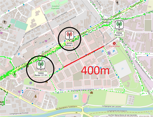

    Unfortunately I wasn't able to find information about the specific cells in your original request on CellMapper, so I can't confirm the location of the actual cells.
  • Dear Andrew,
    first of all, thank you for your detailed explanation!!
    I am having too issues in finding my cells in cellmapper. Thay are in the same eNodeb as your example, but in different sectors which are not in the cellmapper database. however, this is what the radio returns.

  • Hi Marco:
    I now see the same result that you do for that data. It is to be expected that results will sometimes change slightly over time, as data sources get refreshed and updated. However, I'm also seeing what you are seeing, that the second cell no longer changes the accuracy. I'm going to look into this in our data sources to gather more information.
    yes I understand that data can change but this seems really a suspicious concidence. Consider I never got improvement by adding multiple cells in this way.
    Waiting for updates
    Marco
  • Hi, Marco: I've looked more into why my initial results were different from what I see now on nrfcloud. We have multiple data sources for some areas, and we continuously do performance evaluation in order to rank those data sources. The environment where I did my initial test had slightly outdated rankings. While these rankings in general improve our success rate, in very specific cases like this it can decrease accuracy.
    This edge case has given our team some ideas for improvement of this ranking procedure, including checking SCELL vs. MCELL results for uncertainty decreases. I'm sorry if this isn't the answer you were hoping for, but these cases help us improve our service over time.
