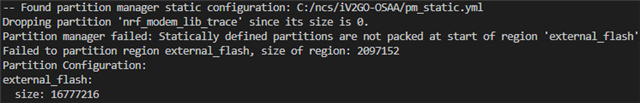

    Another question is: the external flash do not have the correct size, even though I have added the size to the spi setup in the .overlay file. Do I need to add a pm_static.yml for getting the correct sized configured?
  • Okay, I have misunderstood the purpose of the pm_static.yml file.
    Everything is building fine now and the partition_manager_report makes sense to me.

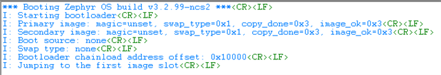

    I have upgraded the SDK version from 2.0.0 to 2.3.0 and it builds fine and when I run it it, it gives this output:
    The only problem is that it never boot up the user app.
    I have added a more verbose logging:

    *** Booting Zephyr OS build v3.2.99-ncs2 ***<CR><LF>
    [00:00:00.591,949] <ESC><dbg> os: k_sched_unlock: scheduler unlocked (0x20000338:0)<ESC><CR><LF>
    [00:00:00.599,731] <ESC><inf> mcuboot: Starting bootloader<ESC><CR><LF>

    [00:00:00.706,146] <ESC><inf> mcuboot: Primary image: magic=unset, swap_type=0x1, copy_done=0x3, image_ok=0x3<ESC><CR><LF>

    [00:00:00.959,075] <ESC><dbg> spi_nrfx_spim: spi_context_update_rx: rx buf/len 0x20005292/1<ESC><CR><LF>
    [00:00:00.967,559] <ESC><inf> NRFX_SPIM: Function: spim_xfer, error code: NRFX_SUCCESS.<ESC><CR><LF>
    [00:00:00.975,677] <ESC><dbg> NRFX_SPIM: irq_handler: Event: NRF_SPIM_EVENT_END.<ESC><CR><LF>
    [00:00:00.983,215] <ESC><dbg> spi_nrfx_spim: spi_context_update_tx: tx buf/len (nil)/0<ESC><CR><LF>
    [00:00:00.991,241] <ESC><dbg> spi_nrfx_spim: spi_context_update_rx: rx buf/len (nil)/0<ESC><CR><LF>
    [00:00:00.999,298] <ESC><dbg> spi_nrfx_spim: transfer_next_chunk: Transaction finished with status 0<ESC><CR><LF>
    [00:00:01.008,575] <ESC><inf> NRFX_SPIM: Function: spim_xfer, error code: NRFX_SUCCESS.<ESC><CR><LF>
    [00:00:01.016,754] <ESC><dbg> spi_nrfx_spim: spi_context_buffers_setup: tx_bufs 0x200051c8 - rx_bufs 0x200051d0 - 1<ESC><CR><LF>
    [00:00:01.027,374] <ESC><dbg> spi_nrfx_spim: spi_context_buffers_setup: current_tx 0x200051d8 (2), current_rx 0x200051d8 (2), tx buf/len 0x200051c0/4, rx buf/len 0x200051c0/4<ESC><CR><LF>
    [00:00:01.043,182] <ESC><dbg> NRFX_SPIM: irq_handler: Event: NRF_SPIM_EVENT_END.<ESC><CR><LF>
    [00:00:01.050,689] <ESC><dbg> spi_nrfx_spim: spi_context_update_tx: tx buf/len 0x20005293/1<ESC><CR><LF>
    [00:00:01.059,173] <ESC><dbg> spi_nrfx_spim: spi_context_update_rx: rx buf/len 0x20005293/1<ESC><CR><LF>
    [00:00:01.067,687] <ESC><inf> NRFX_SPIM: Function: spim_xfer, error code: NRFX_SUCCESS.<ESC><CR><LF>
    [00:00:01.075,805] <ESC><dbg> NRFX_SPIM: irq_handler: Event: NRF_SPIM_EVENT_END.<ESC><CR><LF>
    [00:00:01.083,312] <ESC><dbg> spi_nrfx_spim: spi_context_update_tx: tx buf/len (nil)/0<ESC><CR><LF>
    [00:00:01.091,369] <ESC><dbg> spi_nrfx_spim: spi_context_update_rx: rx buf/len (nil)/0<ESC><CR><LF>
    [00:00:01.099,426] <ESC><dbg> spi_nrfx_spim: transfer_next_chunk: Transaction finished with status 0<ESC><CR><LF>
    [00:00:01.108,703] <ESC><inf> NRFX_SPIM: Function: spim_xfer, error code: NRFX_SUCCESS.<ESC><CR><LF>
    [00:00:01.116,851] <ESC><inf> mcuboot: Secondary image: magic=unset, swap_type=0x1, copy_done=0x3, image_ok=0x3<ESC><CR><LF>
    [00:00:01.127,075] <ESC><inf> mcuboot: Boot source: none<ESC><CR><LF>
    [00:00:01.132,507] <ESC><dbg> spi_nrfx_spim: spi_context_buffers_setup: tx_bufs 0x20005238 - rx_bufs 0x20005240 - 1<ESC><CR><LF>
    [00:00:01.143,127] <ESC><dbg> spi_nrfx_spim: spi_context_buffers_setup: current_tx 0x20005248 (2), current_rx 0x20005248 (2), tx buf/len 0x20005230/4, rx buf/len 0x20005230/4<ESC><CR><LF>
    [00:00:01.158,935] <ESC><dbg> NRFX_SPIM: irq_handler: Event: NRF_SPIM_EVENT_END.<ESC><CR><LF>
    [00:00:01.166,442] <ESC><dbg> spi_nrfx_spim: spi_context_update_tx: tx buf/len 0x20001830/32<ESC><CR><LF>
    [00:00:01.175,018] <ESC><dbg> spi_nrfx_spim: spi_context_update_rx: rx buf/len 0x20001830/32<ESC><CR><LF>
    [00:00:01.183,624] <ESC><inf> NRFX_SPIM: Function: spim_xfer, error code: NRFX_SUCCESS.<ESC><CR><LF>
    [00:00:01.191,741] <ESC><dbg> NRFX_SPIM: irq_handler: Event: NRF_SPIM_EVENT_END.<ESC><CR><LF>
    [00:00:01.199,249] <ESC><dbg> spi_nrfx_spim: spi_context_update_tx: tx buf/len (nil)/0<ESC><CR><LF>
    [00:00:01.207,305] <ESC><dbg> spi_nrfx_spim: spi_context_update_rx: rx buf/len (nil)/0<ESC><CR><LF>
    [00:00:01.215,362] <ESC><dbg> spi_nrfx_spim: transfer_next_chunk: Transaction finished with status 0<ESC><CR><LF>
    [00:00:01.224,639] <ESC><inf> NRFX_SPIM: Function: spim_xfer, error code: NRFX_SUCCESS.<ESC><CR><LF>
    [00:00:01.232,818] <ESC><dbg> spi_nrfx_spim: spi_context_buffers_setup: tx_bufs 0x200051f8 - rx_bufs 0x20005200 - 1<ESC><CR><LF>
    [00:00:01.243,408] <ESC><dbg> spi_nrfx_spim: spi_context_buffers_setup: current_tx 0x20005208 (2), current_rx 0x20005208 (2), tx buf/len 0x200051f0/4, rx buf/len 0x200051f0/4<ESC><CR><LF>
    [00:00:01.259,216] <ESC><dbg> NRFX_SPIM: irq_handler: Event: NRF_SPIM_EVENT_END.<ESC><CR><LF>
    [00:00:01.266,723] <ESC><dbg> spi_nrfx_spim: spi_context_update_tx: tx buf/len 0x20005258/16<ESC><CR><LF>
    [00:00:01.275,299] <ESC><dbg> spi_nrfx_spim: spi_context_update_rx: rx buf/len 0x20005258/16<ESC><CR><LF>
    [00:00:01.283,905] <ESC><inf> NRFX_SPIM: Function: spim_xfer, error code: NRFX_SUCCESS.<ESC><CR><LF>
    [00:00:01.292,022] <ESC><dbg> NRFX_SPIM: irq_handler: Event: NRF_SPIM_EVENT_END.<ESC><CR><LF>
    [00:00:01.299,530] <ESC><dbg> spi_nrfx_spim: spi_context_update_tx: tx buf/len (nil)/0<ESC><CR><LF>
    [00:00:01.307,586] <ESC><dbg> spi_nrfx_spim: spi_context_update_rx: rx buf/len (nil)/0<ESC><CR><LF>
    [00:00:01.315,643] <ESC><dbg> spi_nrfx_spim: transfer_next_chunk: Transaction finished with status 0<ESC><CR><LF>
    [00:00:01.324,920] <ESC><inf> NRFX_SPIM: Function: spim_xfer, error code: NRFX_SUCCESS.<ESC><CR><LF>
    [00:00:01.333,099] <ESC><dbg> spi_nrfx_spim: spi_context_buffers_setup: tx_bufs 0x200051f8 - rx_bufs 0x20005200 - 1<ESC><CR><LF>
    [00:00:01.343,719] <ESC><dbg> spi_nrfx_spim: spi_context_buffers_setup: current_tx 0x20005208 (2), current_rx 0x20005208 (2), tx buf/len 0x200051f0/4, rx buf/len 0x200051f0/4<ESC><CR><LF>
    [00:00:01.359,527] <ESC><dbg> NRFX_SPIM: irq_handler: Event: NRF_SPIM_EVENT_END.<ESC><CR><LF>
    [00:00:01.367,034] <ESC><dbg> spi_nrfx_spim: spi_context_update_tx: tx buf/len 0x20005257/1<ESC><CR><LF>
    [00:00:01.375,518] <ESC><dbg> spi_nrfx_spim: spi_context_update_rx: rx buf/len 0x20005257/1<ESC><CR><LF>
    [00:00:01.384,033] <ESC><inf> NRFX_SPIM: Function: spim_xfer, error code: NRFX_SUCCESS.<ESC><CR><LF>
    [00:00:01.392,150] <ESC><dbg> NRFX_SPIM: irq_handler: Event: NRF_SPIM_EVENT_END.<ESC><CR><LF>
    [00:00:01.399,658] <ESC><dbg> spi_nrfx_spim: spi_context_update_tx: tx buf/len (nil)/0<ESC><CR><LF>
    [00:00:01.407,714] <ESC><dbg> spi_nrfx_spim: spi_context_update_rx: rx buf/len (nil)/0<ESC><CR><LF>
    [00:00:01.415,771] <ESC><dbg> spi_nrfx_spim: transfer_next_chunk: Transaction finished with status 0<ESC><CR><LF>
    [00:00:01.425,048] <ESC><inf> NRFX_SPIM: Function: spim_xfer, error code: NRFX_SUCCESS.<ESC><CR><LF>
    [00:00:01.433,227] <ESC><dbg> spi_nrfx_spim: spi_context_buffers_setup: tx_bufs 0x200051e8 - rx_bufs 0x200051f0 - 1<ESC><CR><LF>
    [00:00:01.443,847] <ESC><dbg> spi_nrfx_spim: spi_context_buffers_setup: current_tx 0x200051f8 (2), current_rx 0x200051f8 (2), tx buf/len 0x200051e0/4, rx buf/len 0x200051e0/4<ESC><CR><LF>
    [00:00:01.459,655] <ESC><dbg> NRFX_SPIM: irq_handler: Event: NRF_SPIM_EVENT_END.<ESC><CR><LF>
    [00:00:01.467,163] <ESC><dbg> spi_nrfx_spim: spi_context_update_tx: tx buf/len 0x200052a2/1<ESC><CR><LF>
    [00:00:01.475,646] <ESC><dbg> spi_nrfx_spim: spi_context_update_rx: rx buf/len 0x200052a2/1<ESC><CR><LF>
    [00:00:01.484,161] <ESC><inf> NRFX_SPIM: Function: spim_xfer, error code: NRFX_SUCCESS.<ESC><CR><LF>
    [00:00:01.492,279] <ESC><dbg> NRFX_SPIM: irq_handler: Event: NRF_SPIM_EVENT_END.<ESC><CR><LF>
    [00:00:01.499,816] <ESC><dbg> spi_nrfx_spim: spi_context_update_tx: tx buf/len (nil)/0<ESC><CR><LF>
    [00:00:01.507,873] <ESC><dbg> spi_nrfx_spim: spi_context_update_rx: rx buf/len (nil)/0<ESC><CR><LF>
    [00:00:01.515,930] <ESC><dbg> spi_nrfx_spim: transfer_next_chunk: Transaction finished with status 0<ESC><CR><LF>
    [00:00:01.525,207] <ESC><inf> NRFX_SPIM: Function: spim_xfer, error code: NRFX_SUCCESS.<ESC><CR><LF>
    [00:00:01.533,355] <ESC><dbg> spi_nrfx_spim: spi_context_buffers_setup: tx_bufs 0x200051e8 - rx_bufs 0x200051f0 - 1<ESC><CR><LF>
    [00:00:01.543,975] <ESC><dbg> spi_nrfx_spim: spi_context_buffers_setup: current_tx 0x200051f8 (2), current_rx 0x200051f8 (2), tx buf/len 0x200051e0/4, rx buf/len 0x200051e0/4<ESC><CR><LF>
    [00:00:01.559,783] <ESC><dbg> NRFX_SPIM: irq_handler: Event: NRF_SPIM_EVENT_END.<ESC><CR><LF>
    [00:00:01.567,291] <ESC><dbg> spi_nrfx_spim: spi_context_update_tx: tx buf/len 0x200052a3/1<ESC><CR><LF>
    [00:00:01.575,805] <ESC><dbg> spi_nrfx_spim: spi_context_update_rx: rx buf/len 0x200052a3/1<ESC><CR><LF>
    [00:00:01.584,289] <ESC><inf> NRFX_SPIM: Function: spim_xfer, error code: NRFX_SUCCESS.<ESC><CR><LF>
    [00:00:01.592,407] <ESC><dbg> NRFX_SPIM: irq_handler: Event: NRF_SPIM_EVENT_END.<ESC><CR><LF>
    [00:00:01.599,945] <ESC><dbg> spi_nrfx_spim: spi_context_update_tx: tx buf/len (nil)/0<ESC><CR><LF>
    [00:00:01.608,001] <ESC><dbg> spi_nrfx_spim: spi_context_update_rx: rx buf/len (nil)/0<ESC><CR><LF>
    [00:00:01.616,058] <ESC><dbg> spi_nrfx_spim: transfer_next_chunk: Transaction finished with status 0<ESC><CR><LF>
    [00:00:01.625,335] <ESC><inf> NRFX_SPIM: Function: spim_xfer, error code: NRFX_SUCCESS.<ESC><CR><LF>
    [00:00:01.633,483] <ESC><inf> mcuboot: Swap type: none<ESC><CR><LF>
    [00:00:01.742,462] <ESC><inf> mcuboot: Bootloader chainload address offset: 0x10000<ESC><CR><LF>
    [00:00:01.750,213] <ESC><inf> mcuboot: Jumping to the first image slot<ESC><CR><LF>
  • When you build, do you have Debugging Options enabled?
    If you do, try to build without Debugging Options.
    Sigurd Hellesvik
