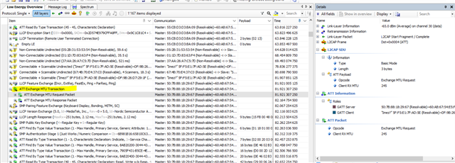

    Sniffer :
    Then from the sniffer trace, we can observe that the transaction from the nrf to the app ( indications or notifications ) use correctly the new MTU, but the app using the nordic android library still considers that the mtu has not changed and continue splitting the long packets in small chunks.
