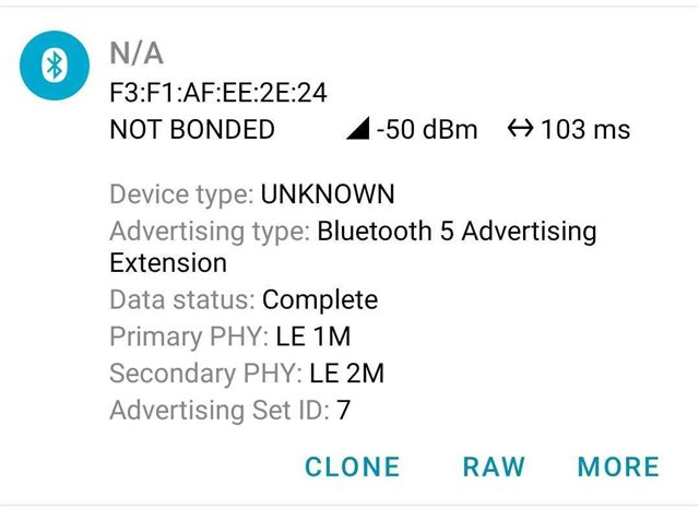

Hello! I'm currently using nRF52 SDK to create a BLE beacon in which I update the advertising data at runtime.
I'm using the provided ble beacon example as a base for my program, I found that if I configure the extended advertising in the advertising initialization, it actually support up 251 bytes in the advertising data, however I don't seem to be able to change the base size past 0x18.
This is how my advertising_init() function looks like:
uint32_t err_code;
uint8_t flags = BLE_GAP_ADV_FLAG_BR_EDR_NOT_SUPPORTED;
manuf_specific_data.company_identifier = APP_COMPANY_IDENTIFIER;
manuf_specific_data.data.p_data = (uint8_t *) m_beacon_info;
manuf_specific_data.data.size = APP_BEACON_INFO_LENGTH;
// Build and set advertising data.
advdata.name_type = BLE_ADVDATA_NO_NAME;
advdata.flags = flags;
advdata.p_manuf_specific_data = &manuf_specific_data;
// Initialize advertising parameters (used when starting advertising).
memset(&m_adv_params, 0, sizeof(m_adv_params));
m_adv_params.properties.type = BLE_GAP_ADV_TYPE_EXTENDED_CONNECTABLE_NONSCANNABLE_UNDIRECTED;
m_adv_params.p_peer_addr = NULL; // Undirected advertisement.
m_adv_params.filter_policy = BLE_GAP_ADV_FP_ANY;
m_adv_params.interval = NON_CONNECTABLE_ADV_INTERVAL;
m_adv_params.duration = 0; // Never time out.
m_adv_params.primary_phy = BLE_GAP_PHY_AUTO;
m_adv_params.secondary_phy = BLE_GAP_PHY_AUTO;
m_adv_params.set_id = 4;
err_code = ble_advdata_encode(&advdata, m_adv_data.adv_data.p_data, &m_adv_data.adv_data.len);
err_code = sd_ble_gap_adv_set_configure(&m_adv_handle, &m_adv_data, &m_adv_params);
The beacon doesn't let me change its max size however because the following setting doesn't go above 0x18 (24 bytes) or it will output an error:
#define APP_BEACON_INFO_LENGTH 0x17
What am I missing to be able to advertise the 251 bytes?
