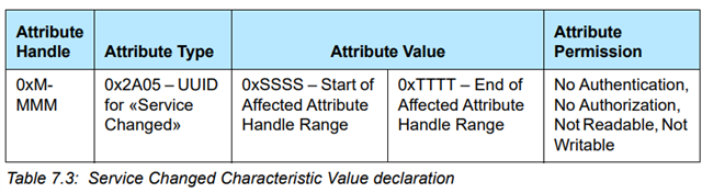

    If we check the Bluetooth Core Specification, we can then see that the Service Changed Characteristic is not meant to be read by the Client. It is only meant to indicate to the Client.
    From Bluetooth Core Specification 5.3, Vol 3, Part G, Section 7.1:
    This Characteristic Value shall be configured to be indicated using the Client Characteristic Configuration descriptor by a client. Indications caused by changes to the Service Changed Characteristic Value shall be considered lost if the client has erroneously not enabled indications in the Client Characteristic Configuration descriptor (see [Vol 3] Part F, Section 3.3.3).
    This makes sense, because only the Server knows when changes in the Server happen. If we leave it to the Client to poll the Server, then it might miss when a change happened, which could result in malfunctions, such as trying to read a characteristic that has been removed.
    This also checks out with my thought above, that the Client (the phones in your case) is doing something wrong.
