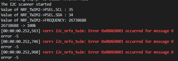

I write some data via I2C. However,it occurs error:
And i2c_transfer return -5, it seems like an I/O error.
I use default I2C pin in nrf5340 audio sample, and I disabled other devices that use I2C, such as the ina231, in the nrf5340 audio sample, so this error is not caused by sharing I2C.

    Can you test this unofficial Simple I2C scanner sample?
    Is it able to scan your sensor?
    Sigurd Hellesvik
    Thank you for your reply.
    I tested with the I2C scanner sample and received the same results.
    Here is the log:
    Is it a hardware issue?
    From nrfx_errors.h we can see that the error code is NRFX_ERROR_INTERNAL.
    I am guessing it is either a devicetree error or a hardware issue.
    Can you post the i2c1 definition from build/zephyr/zephyr.dts?
    To check for a hardware error, connect an oscilloscope or logic analyzer to the I2C lines to look for a signal here.
    How have you connected the I2C sensor to the nRF5340?
    And to clarify, which Development Kit are you using?

    I connected the I2C sensor to the nRF5340 only with SDA/SCL pins, and the I2C sensor has independent power supply.
    I will use an oscilloscope to check hardware issue next week. Before that, I want to confirm whether there is a problem with the software.
    The nRF Connect SDK version I used is v2.2.0.
    I use an oscilloscope to check the signal of the SDA pin, it seems that there is no data output.
    I can't find where the code is wrong. I compared other I2C samples, the writing method is the same, and the I2C pins I use are also the default pins.
    In addition, I tried to test with nrf5340 audio dk instead of nrf5340 module, but got the same error.
    What situation does this I2C error -5 usually appear?
