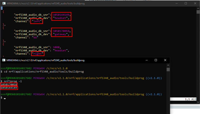

    For the CIS configuration the enviromment was set:
    • NCS version v2.3.0
    • nrf5340_audio_dk_devices.json:
    I used nrfjprog --recover --coprocessor CP_NETWORK && nrfjprog --recover  command to restore the board
    And python buildprog.py -c both -b debug -d both --pristine -p to flash both of them
    By using this configuration do you think we would have succeeded connecting/pairing with nrf5340?
    For BIS mode the configuration was the same for CIS but the addition of CONFIG_TRANSPORT_BIS=y Kconfig option to the prj.conf file
