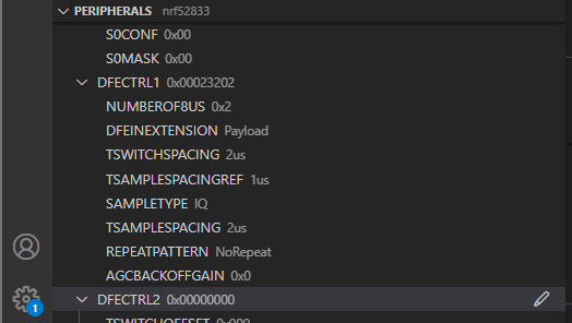

For my project I am interested in performing IQ sampling in the payload of a BLE packet, using nRF52833 at both receiver and transmitter.
I am manually configuring the RADIO peripheral at the receiver. As far as I understand, the bit DFECTRL1.DFEINEXTENSION should do the trick for me, by setting it to 0. However, modifying that bit by writing 0 to that bitfield does not change anything. It stays set to 1.
When I start the debugger and manually flip the bit at a breakpoint using the register editor, it seems to do the trick and the device behaves as expected. How can I achieve this without using the debugger?

  • Hi Simon, thanks for the fast reply.
    My issue right now is just that I cannot modify the DFEINEXTENSION bit for some reason, except when I use the register editor of the debugger as shown in the picture. But when I try to clear the bit in the code, it has no effect. Could there be some kind of write protection on that bit?
  • Edit: I see now that I had a logical mistake on my side. My bad. Thanks for your help!
  • Yes, I got it to work with this DFECTRL1 and DFECTRL2 configuration:
