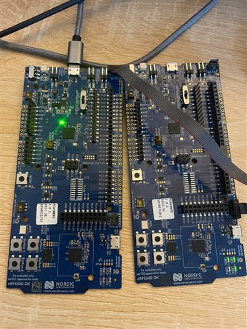

Despite this difference, we are still able to successfully flash an external nRF53840 DK via the debug in connector from another nRF53840 DK (with SB47 shorted). I have included an image below of this setup.
From this image we can see only the external board only has been flashed, as indicated by the firmware switches on LED 1, 2, and 3 on the DK.

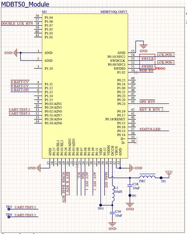

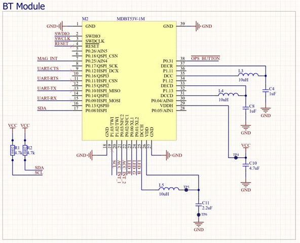

On our custom board we are using a High Voltage DC/DC setup with a supply voltage ranging from 2V to 3.7V (battery powered). We've tried using VDD supplied from the programming DK or by providing power from a constant external source(3.6V) with VDD on the programming pins disconnected, but neither worked. The pins we use for programming are SWDIO, SWDCLK, VDDH and GND.  RESET is not connected, is this needed?
I've attached the schematics for our custom board below .

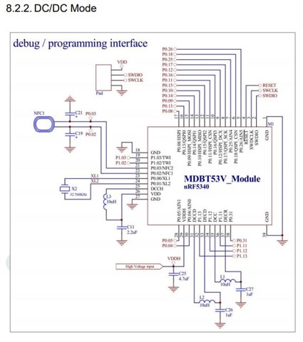

We're using this Raytac module.
Below is Raytac's recommended circuit design for high voltage input.
Another important thing to note is our board does not contain an external LFCLK.
Can you see any issues in our HW design?
    HW design looks fine.
