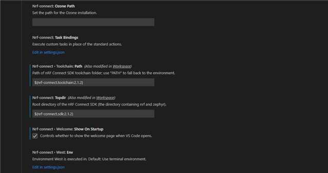

Plugins seems all ok in VSCode (screenshot2) and the nRF Welcome screen is not even displayed anymore...

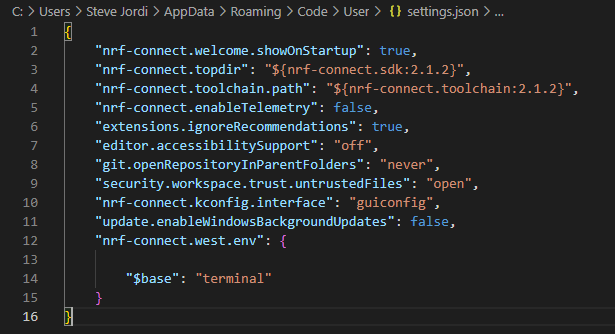

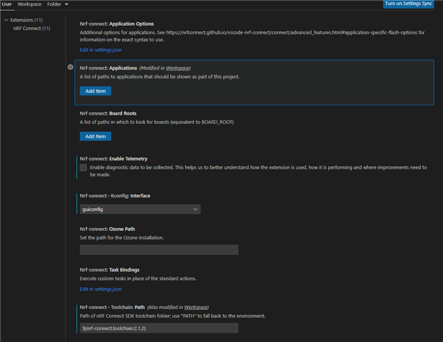

    But then I checked the parameters for the plugin and hey all point to 2.1.1 instead of 2.3.0
    I uninstalled the plugin then nRF Desktop told me I had to install the missing plugin, which it did (from v2.3.0) but the config still shows 2.1.1 and some missing fields. I don't know how to configure them to see whether VSCode takes them into account.
    Fully uninstall all SDK and removed the extension from VSCode and reinstalled 2.3.0, fixed all paths to 2.3.0 but still doesn't work. I'll fully reinstall everything in a clean base Win11Pro VM to see if this works better.
    Here are the parameters for the plugin config (example is 2.1.2
