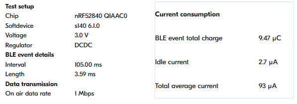

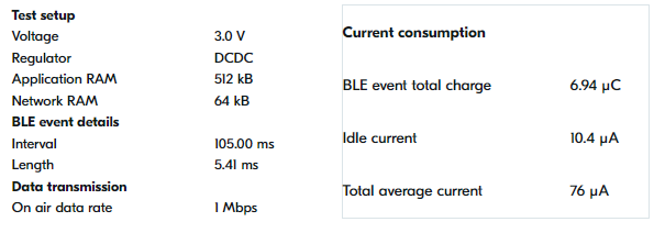

Unrelated, but how does power consumption compare between the nRF5340 and the nRF52840? I would have thought the nRF5340 had higher consumption since it has an additional 128MHz Cortex, but according to the online power profiler, it's actually substantially less (76 µA average for the nRF5340 vs. 93 µA average for the nRF52840). Is this expected, and if so, how is that possible when it has 3x the processing power?
