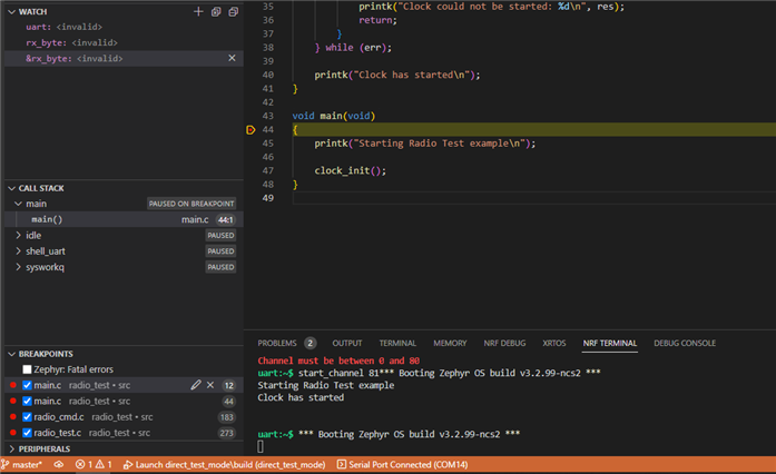

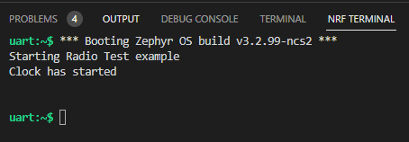

  • Dear Amanda,
    in the apllication radio_test the main.c initialize only clock subsys with function void clock_init(void)
    void main(void)
        printk("Starting Radio Test example\n");
        clock_init();
    I don't understand I seems me when I send commands
    data_rate ble_2Mbit, transmit_pattern pattern_11110000 and start_channel 40 I have a echo ?
    Do I have add any functions ?
    Thanks
