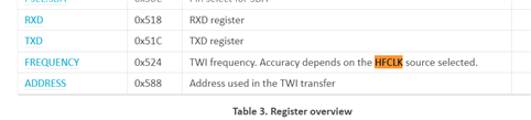

Oh I also want to use I2C (TWI).
For TWI I see the datasheet indicates the FREQUENCY "Accuracy depends on the HFCLK source selected," so I presume that means the internal RC oscillator will allow I2C to function, but perhaps not at the "true" frequency configured.
Please let me know about the rest, thanks!

I think lower speed/baudrate I2C/UART can still function with internal HFRC. I have recently tried some simple communication on UART using internal RC HFCLK even at the baudrate of 115200 and I think the tolerance of the serial COM peripherals is much higher than the efficiency lack of internal RC as compared to crystal.
The way I see it, the peripheral tolerance is directly related to the HFCLK used and I donot see issues with serial peripherals but not use if USB would work properly with internal RC.
