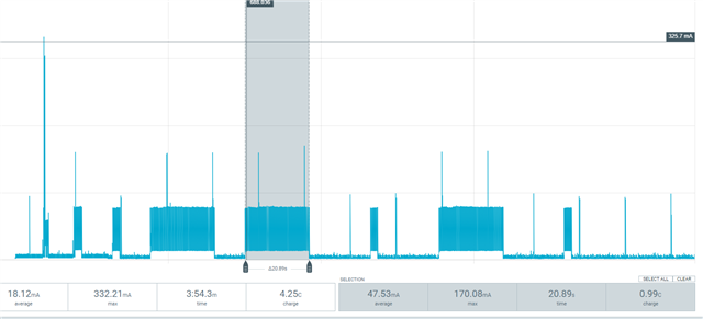

  • I've recently noticed that when manually setting the periodic search, the band optimization is ignored. The pattern of light and deep searches does not represent the band optimization value I've chose. Whether the value is 1 or 20, there's no discernible difference in behavior. See attached picture. Here I've set the search pattern band optimization to 5, so I expect every 5th search to be all the bands I've locked in (2,4,5,12).
    Is this the correct behavior? Have I missed something?
    I do have the data profile set to ultra low power...this value also seem inconsequential.
    I have some insight from our experts.
    <band_optimization> parameter in the %PERIODICSEARCHCONF configuration refers to “all band search” in the AT command document. It is not possible to affect on whether modem does light search or full search. The “all band search” means that every supported band will be fully searched. The other searches in between these “all band searches” are something less, i.e. it does not specifically mean the light search. If there were more bands locked or no band lock at all, the difference could be seen.
    Michal
