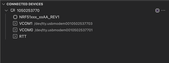

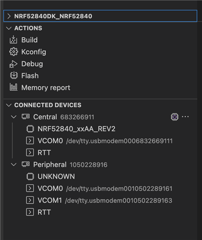

nRF52840 3.0.0 2022.36 shows UNKNOWN in vscode, can't connect
I'm on OSX Ventura 13.2.1 and nRF Connect SDK 2.3.0
I have what I guess is an older board NRF52840_XXAA_REV2 which I am able to flash.  But I just received new boards marked PCA10056 3.0.0 2022.36 which I can't flash.  In VSCode CONNECTED DEVICES I see the old board and the new board shows UNKNOWN (and 2 COM ports).
When I try to flash this new board I get;
* Executing task: nRF Connect: Flash: peripheral_hr_coded/build (active)
Flashing build to Peripheral
west flash -d /Users/leedrengenberg/github/nordic/nRF-Connect-SDK-Fundamentals/v2.x.x/peripheral_hr_coded/build --skip-rebuild -r nrfjprog --dev-id 1050228916 --recover
-- west flash: using runner nrfjprog
-- runners.nrfjprog: Recovering and erasing all flash memory.
Recovering device. This operation might take 30s.
[error] [SeggerBackend] - JLinkARM.dll reported "-1", "An unknown error.".
ERROR: Recover failed. Please make sure that the correct device family is given
ERROR: and try again.
NOTE: For additional output, try running again with logging enabled (--log).
NOTE: Any generated log error messages will be displayed.
FATAL ERROR: command exited with status 62: nrfjprog --recover -f NRF52 --snr 1050228916
I've read several of the other posts and tried
nrfjprog --recover
but got similar errors.  I'm attaching the log file from that.  Maybe my problem has to do with the 2 COM ports?
Thanks for your help!
LeeDr
