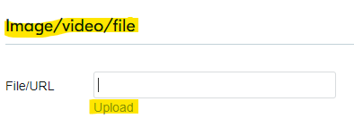

  • Ok, I was able to fix my issue.  The problem was that my bootloader was really old.  I updated it to the latest bootloader using Audrino IDE USB bootloader update function and I was able to use the UF2 file that was in the blog that you mentioned above.  I originally tried that, but the old bootloader just attempted to load the file, but failed silently.  So now the 4.1.0.uf2 file works.  I have created a 4.1.1 version if anyone wants to use it.  It is just the 4.1.1 hex file converted to the uf2 format. Hopefully I can upload it to the nordic website somehow.  Currently it only allows video files.  Let me know where I can upload it so that it won't disappear in the future.
    Glad to hear that the issue has been resolved. You can upload the file using the Insert tab-->Image/video/file-->upload if the format is not supporting try to upload the zip file.
    Thank you for sharing the file as this will help some of the other users in Devzone.
