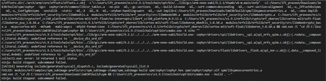

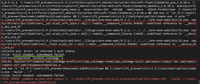

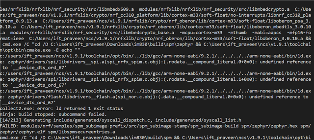

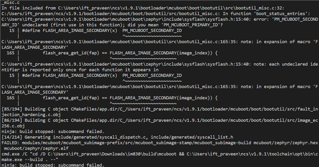

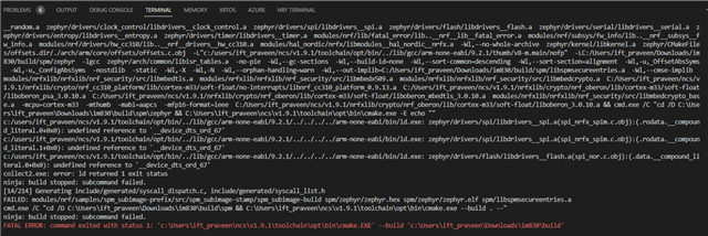

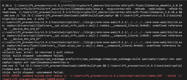

I am getting this build error.
error
Please tell me why I am getting this error. My configurations are correct? How to do it in a proper way?

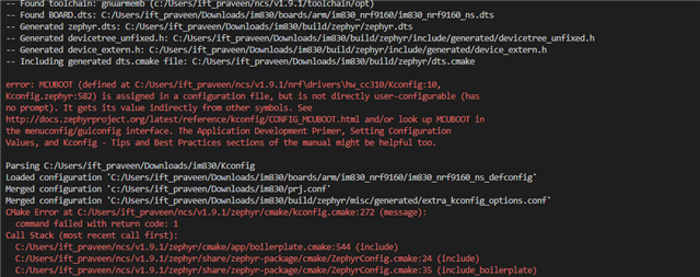

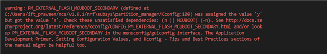

  • Hi, have you tried setting CONFIG_PM_EXTERNAL_FLASH_MCUBOOT_SECONDARY=y in your prj.conf?
  • Hello BenKrug,
    Thank you for your reply.
    if I add CONFIG_PM_EXTERNAL_FLASH_MCUBOOT_SECONDARY=y, It will look like this
    I will get a build time error.
     - Praveen

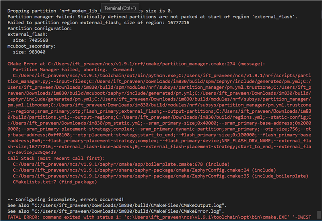

    I think my pm_static.yml partition is wrong, can you please check it.

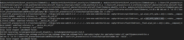

  • The error seems kind of weird to me, did you try making it a pm.yml file instead of pm_static?
  • I changed it to pm.yml, i got this error
    I think my pm.yml/pm_static.yml mcuboot_secondary and external_flash configuration is wrong.
    -praveen

  • I modified your pm.yml with my device name
    pm.yml
    mcuboot:
        address: 0x0
        region: flash_primary
    mcuboot_pad:
        address: 0xc000
    app:
        address: 0xc200
    mcuboot_primary:
        orig_span: &id001
            - mcuboot_pad
            - app
        span: *id001
        address: 0xc000
    mcuboot_primary_app:
        orig_span: &id002
            - app
        span: *id002
        address: 0xc200
    settings_storage:
        address: 0xfe000
    mcuboot_secondary:
        address: 0x0
        device: W25Q64JV
        region: external_flash
    littlefs_storage:
        address: 0xf2000
        device: W25Q64JV
    external_flash:
       address: 0xff000
       device: W25Q64JV
    end up with failed message

  • do you know at what step it's giving the error messages?
  • I suspect on spi driver, spm child image
    c:/users/ift_praveen/ncs/v1.9.1/toolchain/opt/bin/../lib/gcc/arm-none-eabi/9.2.1/../../../../arm-none-eabi/bin/ld.exe: zephyr/drivers/spi/libdrivers__spi.a(spi_nrfx_spim.c.obj):(.rodata.__compound_literal.0+0x0): undefined reference to `__device_dts_ord_67'
    c:/users/ift_praveen/ncs/v1.9.1/toolchain/opt/bin/../lib/gcc/arm-none-eabi/9.2.1/../../../../arm-none-eabi/bin/ld.exe: zephyr/drivers/spi/libdrivers__spi.a(spi_nrfx_spim.c.obj):(.rodata.__compound_literal.1+0x0): undefined reference to `__device_dts_ord_67'
    c:/users/ift_praveen/ncs/v1.9.1/toolchain/opt/bin/../lib/gcc/arm-none-eabi/9.2.1/../../../../arm-none-eabi/bin/ld.exe: zephyr/drivers/flash/libdrivers__flash.a(spi_nor.c.obj):(.data.__compound_literal.0+0x0): undefined reference to `__device_dts_ord_67'
    [17/214] Completed 'mcuboot_subimage'
    FAILED: modules/nrf/samples/spm_subimage-prefix/src/spm_subimage-stamp/spm_subimage-build spm/zephyr/zephyr.hex spm/zephyr/zephyr.elf spm/libspmsecureentries.a
    cmd.exe /C "cd /D C:\Users\ift_praveen\Downloads\im830\build\spm && C:\Users\ift_praveen\ncs\v1.9.1\toolchain\opt\bin\cmake.exe --build . --"
