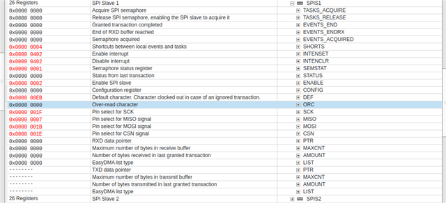

SPI Slave (SPIS) returns 0xD7 instead of default or overrun character before first transaction

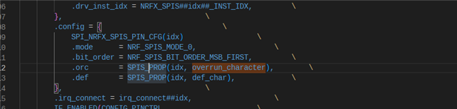

I am using nrf connect zephyr spis driver initialized via devicetree. My default character is 0xEB which is returned if nothing is in the spi slaves buffers.
But before the first transaction is initialized by the software the spis returns 0xD7 instead. I have checked with ozone that the registers for the spis module are initialized, this is the case. So I assume this actually a hardware bug?
In this state the slave return 0xD7

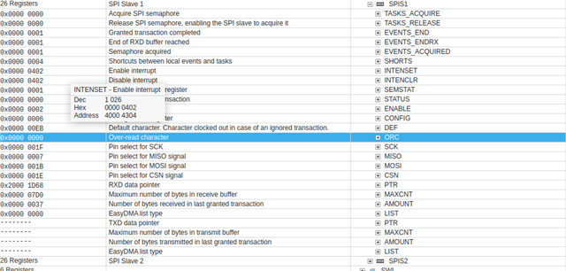

After doing one transaction the slave return 0xEB correctly:
