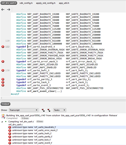

Now, my intention is to use this example and branch out for adding more features, which is not necessary to be explained here. So, for the new project, I moved this examples\ble_peripheral\ble_app_uart out of the examples folder - I update the paths in the ble_app_uart_pca10056_s140.emProject file. Then building the project threw the following error:

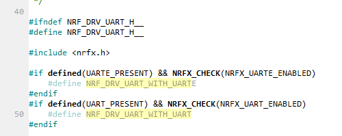

Comparing with the successfully build example in the SDK folder, gave me the hint that, in nrf_drv_uart.h the preprocessor NRF_DRV_UART_WITH_UART undefined.
#if defined(UART_PRESENT) && NRFX_CHECK(NRFX_UART_ENABLED)
    #define NRF_DRV_UART_WITH_UART
But NRF_DRV_UART_WITH_UART must be  defined as UART_PRESENT (in nrf52840_peripherals.h) and
/* Universal Asynchronous Receiver-Transmitter */
#define UART_PRESENT
NRFX_UART_ENABLED (in sdk_config.h) are defined and set respectively.
// <e> NRFX_UART_ENABLED - nrfx_uart - UART peripheral driver
#ifndef NRFX_UART_ENABLED
#define NRFX_UART_ENABLED 1
I suspect, this issue is similar to apply_old_config-h-not-working-as-expected.
Unfortunately, I haven't found a reliable solution/ work around for this. I would appreciate a lot if you could give a coherent response, as I am in fast prototyping stage four research.

    ble_app_uart works fine, when I try to compile it from the examples.
    As I mentioned above this build error is coming up when building at different location ( with correct paths); other examples are working fine with this location.
    To keep the doubt simple:
    a. is there somewhere other than sdk_config.h, the preprocessor UART_ENABLED ?
    b. If not why apply_old_config.h doesn't recognize UART_ENABLED as set even if it is in sdk_config.h?
    c. Very similarly why would NRFX_CHECK(NRFX_UART_ENABLED) is FALSE even though NRFX_UART_ENABLED is 1 in sdk_config.h?

  • Hi Lal,
    No, it should only be defined there. You can search the entire SDK file content to confirm this.
    Is there a symptom that makes you think so? If it is the IDE UI, sometimes it just doesn't unravel the preprocessor correctly.
    apply_old_config.h can set it to 0 depends on other configurations. Are you absolutely sure you didn't change anything other than paths in the project file?
    Hieu
  • Hi Hieu, thank you very much for your quick reply.
    GOT it solved !!!
    The path to sdk_config.h was pointing to "nRF5_SDK_17.1.0_ddde560\config\nrf52840\config" not to the example specific "examples\ble_peripheral\ble_app_uart\pca10056\s140\config"
