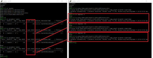

  • The config CONFIG_MPSL_FEM_NRF21540_TX_GAIN_DB will only set the TX GAIN of the FEM, but the system level TX output power is set to 0 dBm by default, which will cause the nRF52xxx chip's TX output power to be lowered to match the system output power. To increase the system level output power, you need to set this for the protocol that you are using (e.g. BLE or OpenThread). For OpenThread, you can use set CONFIG_OPENTHREAD_DEFAULT_TX_POWER to the desired output power (range=[-40, 20]). I tested this with the OpenThread CLI example in nRF Connect SDK v2.3.0 and it gives the correct output power with the nRF21540 DK. The CLI sample also allows you to change the  TX output power dynamically using "ot txpower" command, which makes it easy to test different settings. If you run the CLI example on two boards in the same network, send a ping to the second board after changing txpower, the run "ot neighbor table" command on the second board to see last RSSI.
