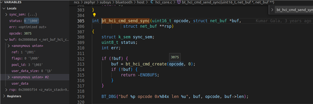

    no, i added a counter to ' on_vs_evt() ' to counts how many times it is called (which should be equal to evt->event_counter i guess) and it is '0' as well,
    i also see that the enable function itself fails on
    int bt_hci_cmd_send_sync(uint16_t opcode, struct net_buf *buf,
    			 struct net_buf **rsp)
    in hci_core.c module (err -5 -> -EIO)
    	status = cmd(buf)->status;
    	if (status) {
    		BT_WARN("opcode 0x%04x status 0x%02x", opcode, status);
    		net_buf_unref(buf);
    		switch (status) {
    		case BT_HCI_ERR_CONN_LIMIT_EXCEEDED:
    			return -ECONNREFUSED;
    		default:
    			return -EIO;
    with:
    0> [00000000] <wrn> bt_hci_core: opcode 0xfd04 status 0x01
    00> [00000000] <err> COMM_MNG: Could not send command buffer (err -5)
    haven't figure out why yet

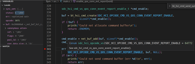

    when i tried to run the llpm example from my ncs (v2.1.0) with nrf52832 board, and i get different values for some reason i can't understand..
    in the above pic is what i see in debug mode, i get a value inserted to the function 64772, and stepping in the function i see a different value - 3075, also the 'buf' values are different .. what am i missing ??
    also it seems like the function ' enable_qos_conn_evt_report ' is called many times which is not clear to me yet, and the ' bt_hci_cmd_send_sync ' is called many times in it , not clear as well ??

  • ok, if i am correct then the issue is this config  ' CONFIG_BT_LL_SW_SPLIT '
    which according to https://developer.nordicsemi.com/nRF_Connect_SDK/doc/latest/zephyr/connectivity/bluetooth/bluetooth-arch.html#bluetooth-build-types
    means i am working with the zephyr BLE stack and not with the nrf connect SDK's softdevice.
    please correct me if i am wrong
    and if i understand correct then zephyr BLE LL des not support the connection event report, again, correct me if i am wrong
