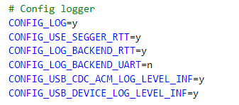

i'm trying to creating a project where my thingy53 is a coap_server thread node that sends environmental data to a coap_clinet (nRF5340).
The problem i found is that, even if i enable LOGs, none of them is shown on the nrf terminal, only works printk(), but not in the main function.
i thought the roblem was correalted to USB CDC ACM that i enabled following the peripheral_uart sample... i don't know if i followed the right procedure, i only compy and pasted overlay files and config commands.
How could i fix these problems? is the correct way to enamble the MTD mode in my thingy?

  • I tryied that but nothing cahnged...
    so i tryied this:
    # Config logger
    CONFIG_LOG=y
    CONFIG_USE_SEGGER_RTT=n
    CONFIG_LOG_BACKEND_RTT=n
    CONFIG_LOG_BACKEND_UART=y
    CONFIG_SHELL_LOG_BACKEND=y
    CONFIG_NET_LOG=y
    CONFIG_NET_CONFIG_LOG_LEVEL_INF=y
    and this is what it prints out:

  • i just added this but doesn't work neither:
    # Config logger
    CONFIG_LOG=y
    CONFIG_NET_LOG=y
    CONFIG_LOG2_MODE_DEFERRED=y
    this is what termila prints:

  • Seems CONFIG_LOG2_MODE_DEFERRED=y is deprecated in v2.1.2. Try CONFIG_LOG_MODE_DEFERRED=y.
    -Amanda H.
  • even with that, nothing change...
    i tried to add these line of code, took by the file thingy53_nrf5340_cpuapp.conf  in the boards folder of the peripheral_uart sample:
    # Config logger
    CONFIG_LOG=y
    CONFIG_NET_LOG=y
    CONFIG_LOG_PRINTK=y
    CONFIG_LOG_PROCESS_THREAD_STACK_SIZE=1024
    CONFIG_LOG_PROCESS_THREAD_STARTUP_DELAY_MS=4000
    and logs looks better:
