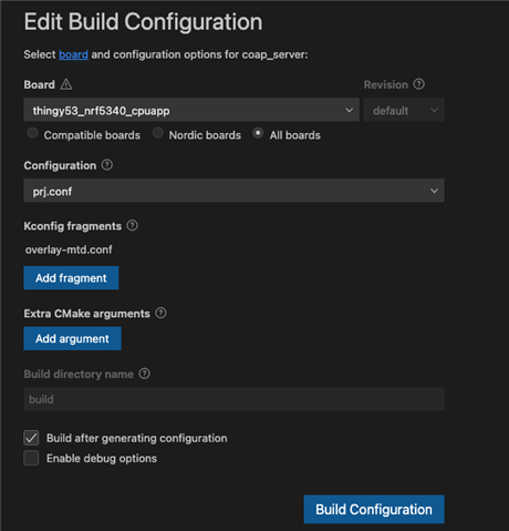

i'm trying to creating a project where my thingy53 is a coap_server thread node that sends environmental data to a coap_client (nRF5340).
The problem is that i'm trying to configure the thingy53 as a minimal thread device, so i added to Cmakelist.txt this line:
cmake_minimum_required(VERSION 3.20.0)
set(CONF_FILE "overlay-mtd.conf")
project(NONE)
where overlay-mtd.conf is a conf file taken by the coap_client sample, but i don't know if this is the correct way to do this.
when i build nothing change...
so i tried to modify the build configuration over the GUI, but something went wrong:

If i reset te build configuration through GUI and start the build again, this is the result:

How could i fix these problems? is the correct way to enamble the MTD mode in my thingy?
