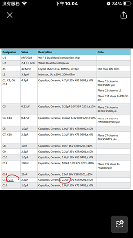

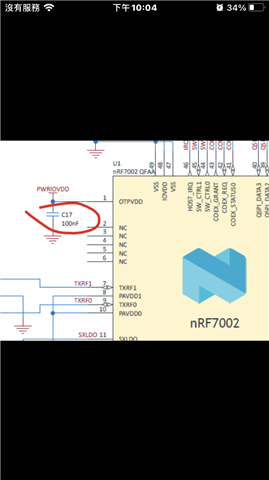

In the nrf7002 spec, reference design C17= 100nF and description C17 = 2.2uF, the two C17 are different. Please confirm, thank you~

The schematic is correct.
