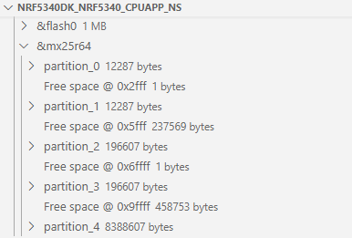

Partition Manager for External Memory doesn't create correctly the partitions.
   I created the regions.yml and pm_static.yml. If I enable this flag the compiler works well
but doesn't create the correct partitions I wrote on pm_static.
##CONFIG_PM_PARTITION_REGION_SETTINGS_STORAGE_EXTERNAL=y
  If I uncomment, these errors appears:
-- Found partition manager static configuration: C:/Nordic/peripheral_uart/pm_static.yml
Dropping partition 'nonsecure_storage' since it is empty.
  File "C:/ncs/v2.3.0-rc1/nrf/scripts/partition_manager.py", line 1978, in <module>
    main()
  File "C:/ncs/v2.3.0-rc1/nrf/scripts/partition_manager.py", line 1028, in main
    solution.update(solve_region(pm_config, region, region_config,
  File "C:/ncs/v2.3.0-rc1/nrf/scripts/partition_manager.py", line 971, in solve_region
    get_region_config(partitions, region_config, static_partitions, system_reqs=pm_config)
  File "C:/ncs/v2.3.0-rc1/nrf/scripts/partition_manager.py", line 742, in get_region_config
    solve_simple_region(pm_config, start, size, placement_strategy, region_name, device,
  File "C:/ncs/v2.3.0-rc1/nrf/scripts/partition_manager.py", line 790, in solve_simple_region
    address += pm_config[partition_name]['size']
KeyError: 'size'
CMake Error at C:/ncs/v2.3.0-rc1/nrf/cmake/partition_manager.cmake:304 (message):
  Partition Manager failed, aborting.
   Could you help me?
Flavio.

file pm_static.yml
partition_1:
  address: 0x0
  end_address: 0x7FFFFF
  region: external_flash

  • I would like to create custom partitions (partition_1) on external flash memory. I created the pm-static.yml and the regions.yml.
    on pm-static.yml
    partition_1:
      address: 0x0
    After "Build all configurations" it's not appearing correctly on file /built/partitions.yml. On this file apears only:
    external_flash:
      address: 0x0
      end_address: 0x800000
    If I setup this command: CONFIG_PM_PARTITION_REGION_SETTINGS_STORAGE_EXTERNAL=y
    on file prj.conf and I press "Build all configurations" return this error I showed.
    With CONFIG_PM_PARTITION_REGION_SETTINGS_STORAGE_EXTERNAL=n works but don't create any
    partition.
    I used as base, peripheral-uart example.

    &mx25r64 {
    	label ="memoria";
    	partitions {
    	 #address-cells = <1>;
    	 #size-cells = <1>;
    	 partition1_label: partition@0 {
    		label = "partition_0";  //32 pages of 4kbytes = 128k
    		reg = <0x00000000 0x000002FFF>;
    	 partition2_label: partition@3000 {
    		label = "partition_1"; //32 pages of 4kbytes = 128k
    		reg = <0x00003000 0x000003FFF>;
    	 partition3_label: partition@40000 {
    		label = "partition_2";      //48 pages of 4bytes = 192k
    		reg = <0x00040000 0x00002FFFF>;
    	 partition4_label: partition@70000 {
    		label = "partition_3";   //48 pages of 4kbytes = 192k
    		reg = <0x00070000 0x00002FFFF>;
    	 partition5_label: partition@110000 {
    		label = "partition_4"; //1797 pages of 4kbytes = 7Mb
    		reg = <0x00110000 0x0007FFFFF>;
            //TOTAL USED 768K
    partition_0:
      address: 0x0
      end_address: 0x1FFF
    partition_1:
      address: 0x2000
      end_address: 0x3FFF
    external_flash:
      base_address: 0x0
      default_driver_kconfig: CONFIG_PM_EXTERNAL_FLASH_HAS_DRIVER
      device: DT_CHOSEN(nordic_pm_ext_flash)
      dynamic_partition: null
      placement_strategy: start_to_end

  • Hello Dejan,
       I want to create partitions on external memory mx25r64.
       Each partition will store some variables structures as a circular buffer.
    This is the layout I want:
      Could you help me?
    Flavio.
