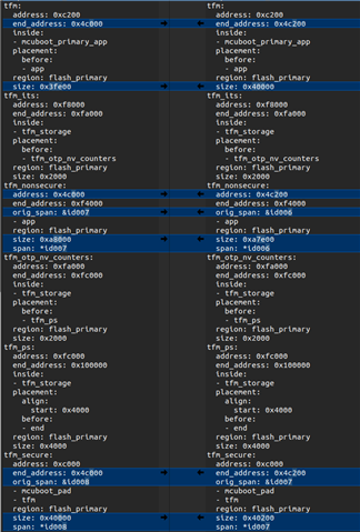

TF-M partition alignment assert within SPU might fail for some partition-manager computed configs
v2.3.0 of the sdk-nrf included this commit that checks for the alignment of the TF-M Non Secure partition (which hosts the `app` one) with CONFIG_NRF_SPU_FLASH_REGION_SIZE .
#define IS_ALIGNED_POW2(value, align) (((value) & ((align) - 1)) == 0)
#if !(IS_ALIGNED_POW2(PM_TFM_NONSECURE_ADDRESS, CONFIG_NRF_SPU_FLASH_REGION_SIZE))
#error "TF-M non-secure address start is not aligned on SPU region size"
For stock/most cases (eg. hello_world code), the assertion holds and the project compiles.
The problem arouses when the partition_manager.py script outputs a layout solution in which the resulting PM_TFM_NONSECURE_ADDRESS becomes non-aligned. This has been my experience with the current project that I'm working on.
To temporarily mitigate this, I ended up taking out the alignment assertion check altogether.
Is this a safe thing to do or is there any other better solution to this?

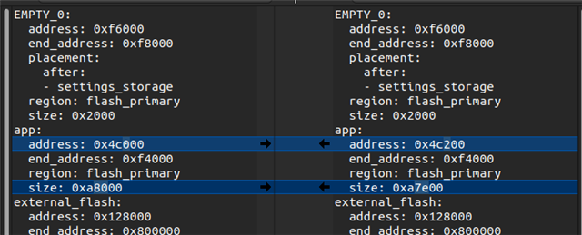

    First I'd like to apologize for this issue and inconvenience.
    I have edit'ed my initial answer. The workaround is to adjust the partition layout via. pm_static.yml (ie. do not change CONFIG_FPROTECT).
    Here's an example of an NCS v2.2.0 layout (with this 0x200 offset, which we do not want for NCS v2.3.0):

    There are some id's and others that are different here, but the major difference are these:
    On the left hand side, all the 0x200 byte offsets are adjusted and rounded down to the correct base address.
    At this moment, I do not have any other fix than to manually adjust these. This can be done by adjusting your already present pm_static.yml, or generating a new build with NCS v2.3.0, and comparing this with your "old pm_static.yml" and adjusting accordingly.
