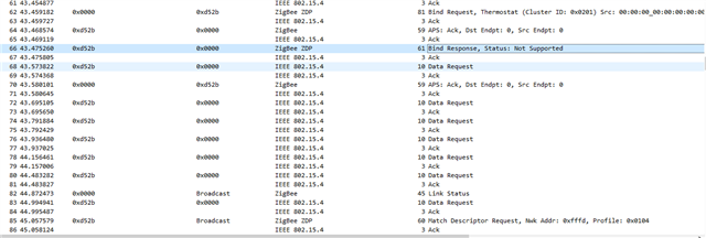

              The aim here is to get reporting data from end device. I can now send bind request from zigbee coordinator to end device. But the end device responds with status not supported. When i am testing with third party coordinator such as deconz, I am able to receive bind response with status success.I am attaching the wireshark logs of deconz and our zigbee coordinator. Comparing the wireshark logs, the difference I can see is that the source and destination addresses are interchanged with respect to deconz log. So I also tried interchanging the source and destination addresses in my code, but then I was not able to send the bind request. I have also attached the code for your reference. What is the correct way to send bind request?

    What is the difference between the two sniffer traces? As far as I can tell, it is the coordinator sending the bind request in both cases, but it was only accepted in one of them? I assume you don't have the source code of the deconz device? And that it doesn't use the same stack?
    Is it possible to send the pcapng files, so that I can look at the packets?
