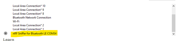

I recently purchased NRF52840DK version 3.0.0 and I was trying to setup the BLE Sniffer. But in wireshark I'm not able to see the interface

Have you installed the correct firmware for the nRF52840dk? You need to install sniffer_nrf52840dk_nrf52840_4.1.0.hex file.If you have installed it properly then your device will be visible in the nRF connect for Destop Programmer as nRF sniffer for Bluetooth See the below screenshot:
If this works well, then you can follow all the steps mentioned here.

I have used latest firmware (sniffer_nrf52840dk_nrf52840_4.1.1.hex). flashing via programmer was success but in programmer it shows as below only
Sorry it's a mistake from my side. My PC was connected with nRF dongle runnig with sniffer firmware and I overlooked this with DK. After flashing the DKs it won't change the name as you can see in my previous screenshot it's also nRF52840DK. But when you open the Wireshark you can see the device as nRF sniffer for Bluetooth:
Are you able to see your device like this?
