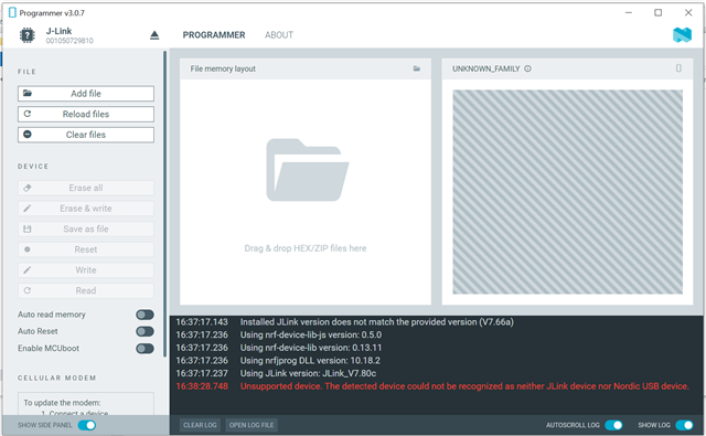

The conclusion in that discussion was to obtain an SWD cable and fully erase the Thingy:53 over a DK (I'm using an nRF7002DK). Finally I obtained the cable and tried to do the operation with no success. This is the setup for Thing:53:
And this is the case when I open the programmer, the usb connected setup recognized as J-link, and please check the message "unsupported device. The detected device coulnd not be recognized as neither Jlink device nor Nordic USB device"

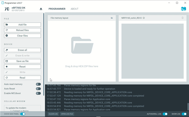

However if I connect my Thingy:91 with exactly the same components, USB and SWD cable, the devkit:
I see my connected device as nRF7002DK (instead of j-link) and I can see that in the log that everything is fine and I can read the memory, erase/write etc.
and here's the full log.

And this is the output when I click on "read", so everything is OK for Thingy 91:

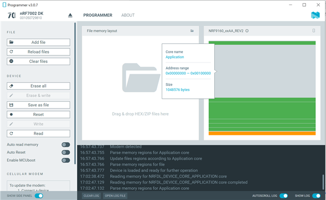

it again works fine with Thingy:91:
and if we read the memory with the programmer, it's totally empty:

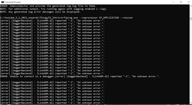

However for the thingy 53, I can't erase or even read with the nrfjprog (recover):
Same thing happens with the Network core. And as far as I can tell, after each access attempt (be it read/write/recover), the thingy53 gets a reset.
nrfjprog version: 10.19.0 external
JLinkARM.dll version: 7.80c
programmer version 3.0.7
