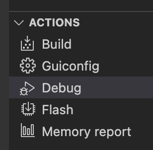

    • I am doing all my actions from the nRF Connect tab on the Activity bar:
    Based on your question about what board specifically I was using, the answer is that I've been using the nrf5340dk_nrf5340_cpuapp_ns.  Since you inquired, I thought I should try the nrf5340dk_nrf5340_cpuapp to see if I got different results and I am pleased to tell you that the nrf5340dk_nrf5340_cpuapp works well and I am able to debug over and over with no issues.  That is good news for me because I could simply use that going forward.
    I did some more testing with the nrf5340dk_nrf5340_cpuapp_ns.  I found that I am able to flash the device successively without issue, so it looks like the Debug action is where the problem is.
