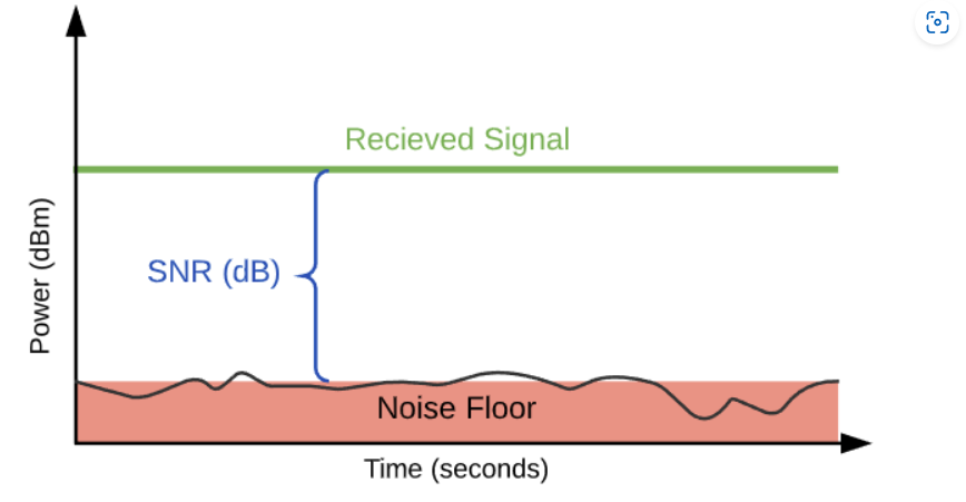

  • I have some confusion with regards to the SNR calculation suggested by Nordic in mail trail below. I would like to understand your opinion.
    I was going through this site Signal-to-Noise Ratio (SNR) and Wireless Signal Strength - Cisco Meraki
    Since the SNR is difference in between the Received signal and the Noise floor , I have one query with respect to the answer received from Nordic.
    According to Nordic inputs : SNR is as follows:
    If this is so then higher the sensitivity of our antenna higher is the ability to detect weaker signals. Thus if sensitivity is -96dbm at 1mbps with packet size < 37bytes ,as per snap shared by @Shinde, Ramesh T (refer mail below), then for a actual signal (good signal) of -70dbm then SNR is -70 –(-96dbm) = 26dbm which is a very good SNR value. i.e. since the difference between the required signal and the noise signal is big. While it may be so that the other noisy signal in the area are having the signal strength of -80dbm as well, which will intern lead to a SNR of -70-(80)dbm = 10db. Which is not so good SNR.
    So my understanding is that the SNR should not be related to sensitivity, but to the overall noise floor of the region.

    hiteshk014 said:
    Any Ideas how do we get the signal strength of noise floor in the area?
    I'll start by defining what exactly RSSI is a measure of because it is vital in order to understand how it relates to SNR and noise floor. The Received Signal Strength Indicator is a measure of the received RF signal in a given channel at the point of sampling. In essence it's an ADC sample of the voltage present in the receiver's analog front-end. The vital piece of infromation here is that any RF signal present in the given or adjacent channels will increase the value of the measured RSSI. RSSI does not directly measure the signal strength of any particular signal, but the sum strength of all of signals present.
    Usually RSSI is sampled automatically when receiving a packet in order to estimate its signal strength, but you can also sample RSSI manually when you are not receiving a packet. If you sample each channel while your wanted signal is not present you can estimate the noise floor based on the RSSI samples.
    I'm not quite sure what problem you are trying to solve by estimating the current SNR for a particular radio link, but if it is to improve Packet Error Rate for BLE links then I suggest you study the Bluetooth LE Quality of Service module for nRF Desktop, as it solves that exact problem. It increases PER by identifying noisy channels and updating the BLE connection's Channel Map where the noisy channels are removed.
    Since RSSI is only an indication of RSS, you can only find an indication of SNR.
