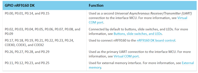

    to add the ccs811 sensor to the board config. I've put the reset, int, and wake pins on 23, 24, and 25 as they didn't conflict with anything. The application builds successfully. However, when I flash to the 9160 dk DEVICE_DT_GET_ONE(ams_ccs811) returns a NULL pointer. As a result, device_is_ready(dev) says device is not ready and the application doesn't advance. From reading it seems this is because the device isn't initialized. How can I get it to do this?
    Thanks
    Looking at the GPIO interfaces of the nRF9160DK it does look like these are used/conflicting, You could test with P0.00, P0.01, P0.14, and P0.15, or use pins that are not listed in GPIO interfacce
