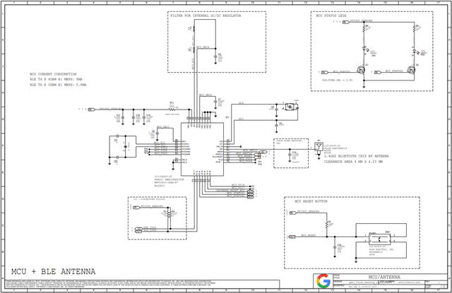

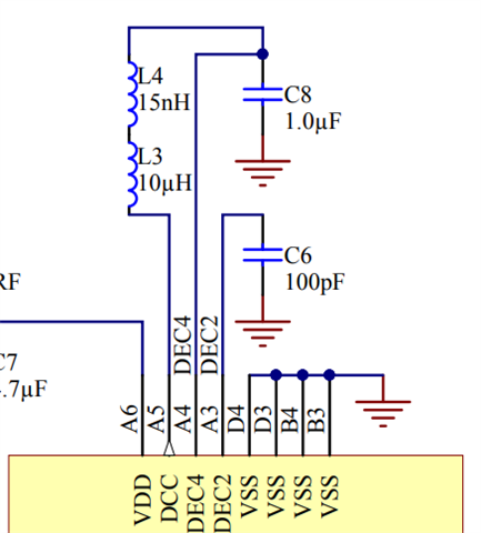

So for the Crystals, we often recommend to ground even the NC pin, it is not necessary. Reason for this is that we have seen some cases where customers has mounted the crystals with a 180 degree rotation. And as far as i am aware we have not seen any down sides by grounding the NC pin.
But feel free to do as the datasheet recommend, as that is the actual recommendation of the components that you are using.

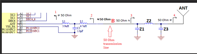

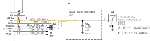

tmarera said:Antenna matching is optional. The antenna input impedance is 50 ohm.

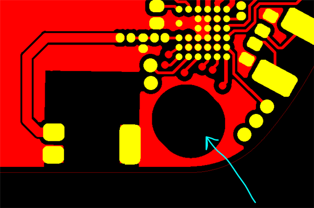

It often says optional in the datasheets of these chip antennas, but more often then not there needs to be some tuning. This is due to the fact that there are other factors that is effecting the antenna, like the casing of the product and in what environment it is mounted.
I like to recommend a full Pi-network as close to the antenna as possible. And since you do in fact have a large hole right next to the antenna, probably for the mounting mechanism of the PCB, it can\will effect the antenna, so it is likely that some tuning is needed for optimal performance.

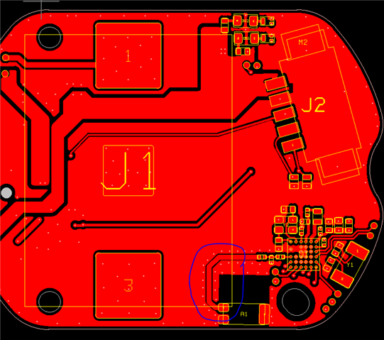

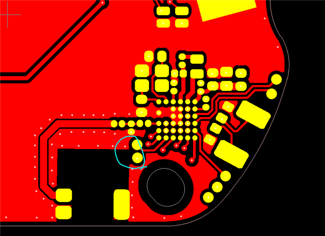

The ground area on the top layer around the antenna should ideally be a consecutive layer, so try to tie the two sections of top layer GND together.
There seems to be enough room to move the SoC and the components further in that would give you more room to have a consecutive plane around the antenna.
I am curious about the J1, how large is it an will it cover parts of the antenna or the transmission line? This could effect the impedance of the trace.

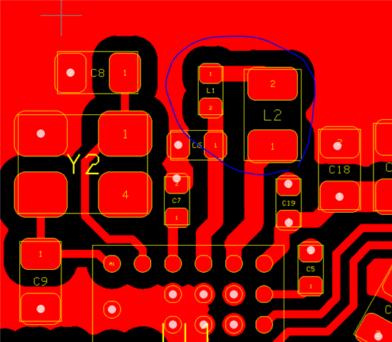

L1 and L2 should not be placed orienting the same way, the inductors have a chance of resonating so to minimize the risk one of the inductors should be rotated 90 degrees.
