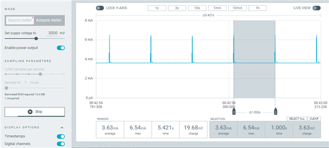

As a starting point I build the Matter sample Window covering with SSED enabled. However using the nrf5340dk_nrf5340 with a PPK2 I did not see the device entering sleep mode as described after I commissioned it with chip-tool.

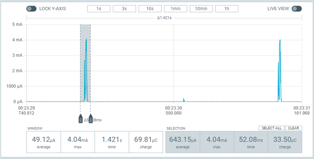

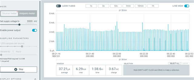

After this last command the nrf5340dk_nrf5340 enters the low_power function and the uart gets closed.
As you can see my measurement is way above the average sleep current of 4.02 µA
Does anybody know what I'm doing wrong? Is my hardware not set up correctly or is there more stuff the software to be configured?
