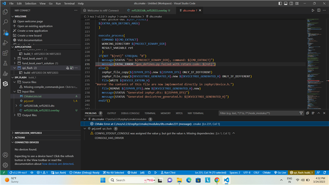

hi i'm new to developing nrf applications i have practised the sampled examples from https://academy.nordicsemi.com/courses/nrf-connect-sdk-fundamentals/ but i'm unable to connect using the spi interface. I am currently using nrf connect sdk v2.2.0. It would be really helpful if you can help me establish spi communication with my external flash.

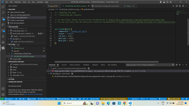

  • A good place to start is the zephyr\samples\drivers\spi_flash example. It's designed for a different board but the application looks in your device tree for spi_flash0. I'd create an overlay for spi_flash0 for your flash with your SPI configurations and go from there.

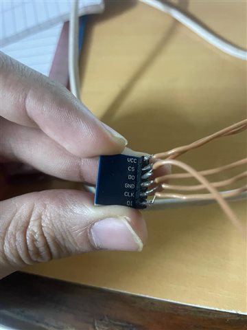

  • tysm that would be really helpfull to understand. Can you also guide me as to what would be the pin out configuration to connect w25qxx to nrf52833dk or if not what to refer for pin out configuration. i am attaching a photo of my flash memory pin out. Also can you guide me as to what changes has to be made or not.

  • i've looked at this thread it's building for nrf52822 but not for nrf52833. As mentioned in the thread i have enabled CONFIG_SPI_NOR=y. I'll attach the files and can you please help me out with this.
