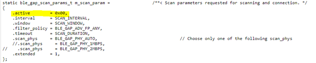

#define SCAN_INTERVAL               0x0320                              /**< Determines scan interval in units of 0.625 millisecond. */
#define SCAN_WINDOW                 0x0320                              /**< Determines scan window in units of 0.625 millisecond. */
#define SCAN_DURATION           	0x0000                              /**< Duration of the scanning in units of 10 milliseconds. If set to 0x0000, scanning continues until it is explicitly disabled. */
NRF_BLE_SCAN_DEF(m_scan);                                   /**< Scanning Module instance. */
static bool                  m_memory_access_in_progress;   /**< Flag to keep track of ongoing operations on persistent memory. */
static ble_gap_scan_params_t m_scan_param =                 /**< Scan parameters requested for scanning and connection. */
    .active        = 0x00,
    .interval      = SCAN_INTERVAL,
    .window        = SCAN_WINDOW,
    .filter_policy = BLE_GAP_ADV_FP_ANY,
    .timeout       = SCAN_DURATION,
    .scan_phys     = BLE_GAP_PHY_AUTO,                                 // Choose only one of the following scan_phys
    //.scan_phys     = BLE_GAP_PHY_1MBPS,
//    .scan_phys     = BLE_GAP_PHY_2MBPS,
    .extended      = 1,

Also I'm using two nRF52840 DKs with nrf SDK 16.
I appreciate any advise anyone can give me.
Thanks in advance and best regards.
Gabriel
