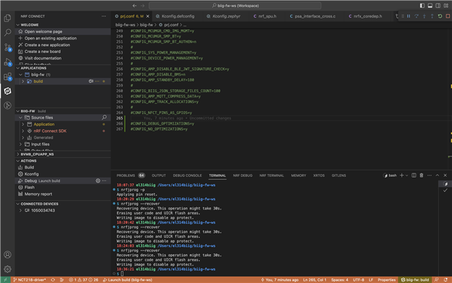

I have such a problem. Debug in VSCode doesn't work as it is supposed to.
(!) If I don't tick Enable debug options in Edit Build Configuratioin then by pressing Debug Launch build I can debug but with stipulations. A part of my code is not accessible, probably it optiized, breakpoints are ignored and this code is never touched by the processor/compiler/system.
- How to workaround this? How not to optimize my code?
- + I have played with some config like DEBUG_OPTIMIZATION and NO_OPTIMIZATION, my code just can't be built.
- Why I even have a possibility to run Debug if  I didn't tick Enable debug options in Edit Build Configuratioin?
(!) If I tick Enable debug options in Edit Build Configuratioin then by pressing Debug Launch build my program just runs as it would be run after Flashing (w/o Debug). But I have that DEBUG CONSOLE OUTPUT with some information so the last lines are:
Thread 4 received signal SIGTRAP, Trace/breakpoint trap.
[Switching to Thread 3939856308]
There are even debug flow buttons. But they doesn' work, only Pause, Restart and Stop are available and Pause doesn't do nothing, Restart breaks everything so that even nRF5340 DK is not available anymore.
What's going on there?

    Could you please rephrase the following part "by pressing Debug Launch build my program just runs as it would be run after Flashing (w/o Debug)"?
    Dejan
  • 1. For example this part:
    *1* const struct device* nct218_dev = DEVICE_DT_GET_ONE(onnn_nct218);
    *2* if (!device_is_ready(nct218_dev)) {
    LOG_ERR("NCT218: device not ready");
    return -ENODEV;
    *1* is the first breakpoint. It's not available, just disappear in debug.
    *2* is the second breakpoint. Debug moves it to the next line but I want to dive into exactly that statement. What's wrong?
    2. Debug button in the nRF Connet extension for VSC
    3. Stipulations are: A part of my code is not accessible, probably it optiized, breakpoints are ignored and this code is never touched by the processor/compiler/system.
    4. File attached12453.log.log
    5. Could you please explain what does it change and where? I mean that Tick in GUI in VSC.
    6. Rephrasing: If I tick Enable debug options in Edit Build Configuratioin then it doesn't matter if I press Debug or Flash, my program runs ignoring all the breakpoints there is not Debug related menu, register's values on the left side of the screen. See the screenshot. The only attribute I see is Debug flow control in ther right upper corner.
    Build optimizations prevent setting the breakpoints on the lines which do not exist in the final build.
