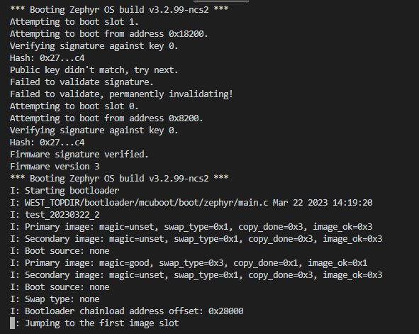

mcuboot DFU, public key didn't match
I am adding a bootloader to my project for OTA DFU.
App core and net core update was successful in the 1st stage bootloader configuration,
I'm configuring a second stage bootloader to update the bootloader.
My settings are below.

The build completes successfully, and signed_by_mcuboot_and_b0_s1_image_update.bin is created.
OTA DFU using the above file succeeds without error.
But looking at the mcuboot log it fails as below.
The signing key configuration is using the one inside ncs.
Is there something I'm missing?
