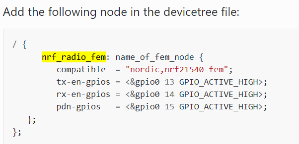

    To enable FEM support, you must add an nrf_radio_fem node in the devicetree file. The node can also be provided by the devicetree file of the target development kit or by an overlay file.

    So I added this to to app.overlay
    	nrf_radio_fem: nrf21540_fem {
    		compatible = "nordic,nrf21540-fem";
    		tx-en-gpios = <&arduino_header 11 GPIO_ACTIVE_HIGH>;   /* D5 */
    		rx-en-gpios = <&arduino_header 9 GPIO_ACTIVE_HIGH>;    /* D3 */
    		pdn-gpios = <&arduino_header 15 GPIO_ACTIVE_HIGH>;     /* D9 */
    		ant-sel-gpios = <&arduino_header 10 GPIO_ACTIVE_HIGH>; /* D4 */
    		mode-gpios = <&arduino_header 8 GPIO_ACTIVE_HIGH>;     /* D2 */
    		supply-voltage-mv = <3000>;
    Now the pins are wiggling, but I'm getting some build warnings, and I don't seem to be able to manipulate the FEM_MODE and ANT_SEL signals the same.  Is this the right way to implement nRF21540 on nRF5340?
