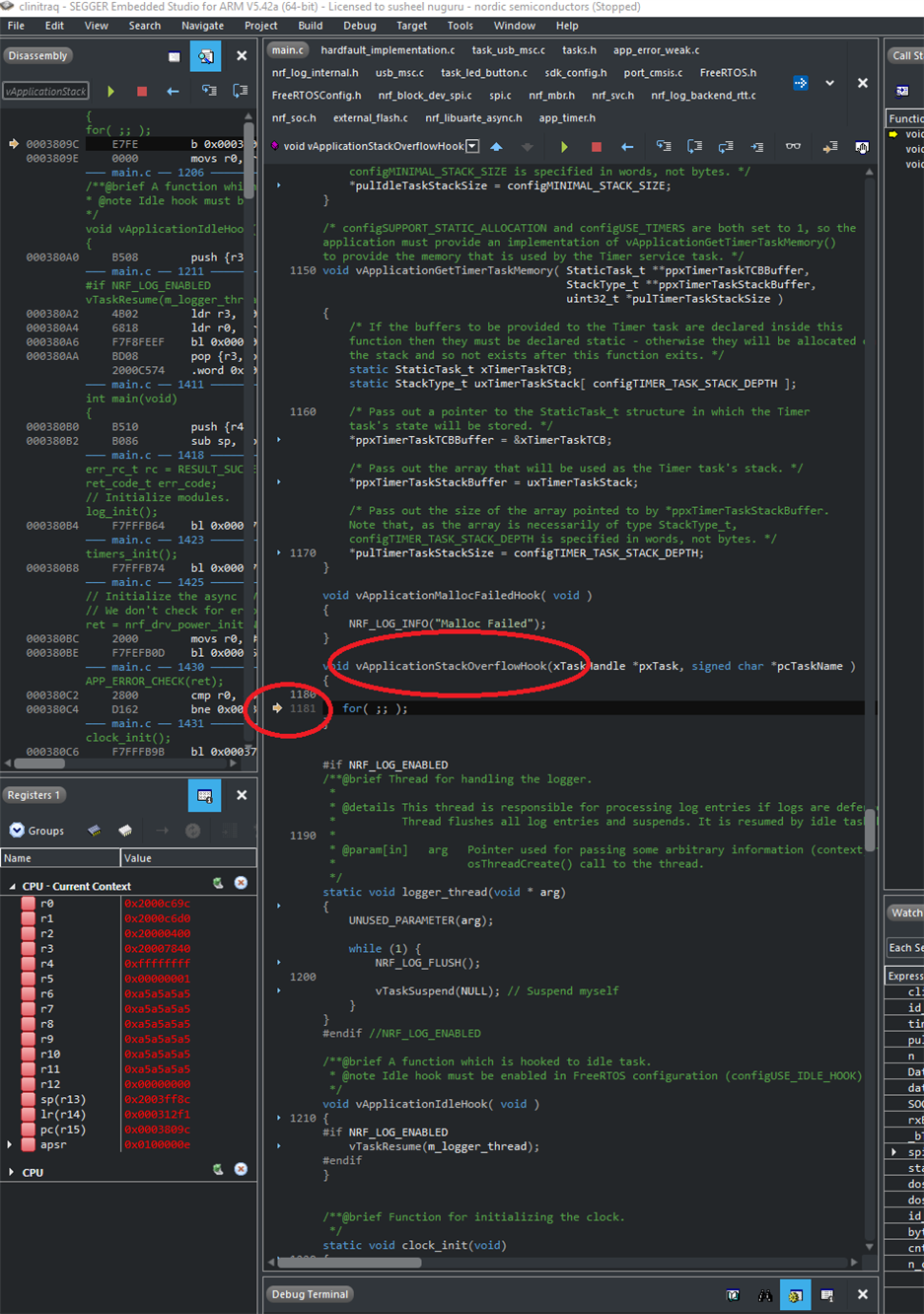

void vApplicationMallocFailedHook( void )
    NRF_LOG_INFO("Malloc Failed");
void vApplicationStackOverflowHook(xTaskHandle *pxTask, signed char *pcTaskName )
   for( ;; );

  • Thanks for waiting Snehal,
    I see that your project have a stack overflow as it seems to call the stackoverflow application hook function.
    Your settings of USBD_PRIORITY and  not sure if you have used enough USBD_STACK_SIZE?
    changing those values to below atleast do not give stack overflow error.
    #define USBD_STACK_SIZE 2*512
    StackType_t usb_msc_stack[ USBD_STACK_SIZE];

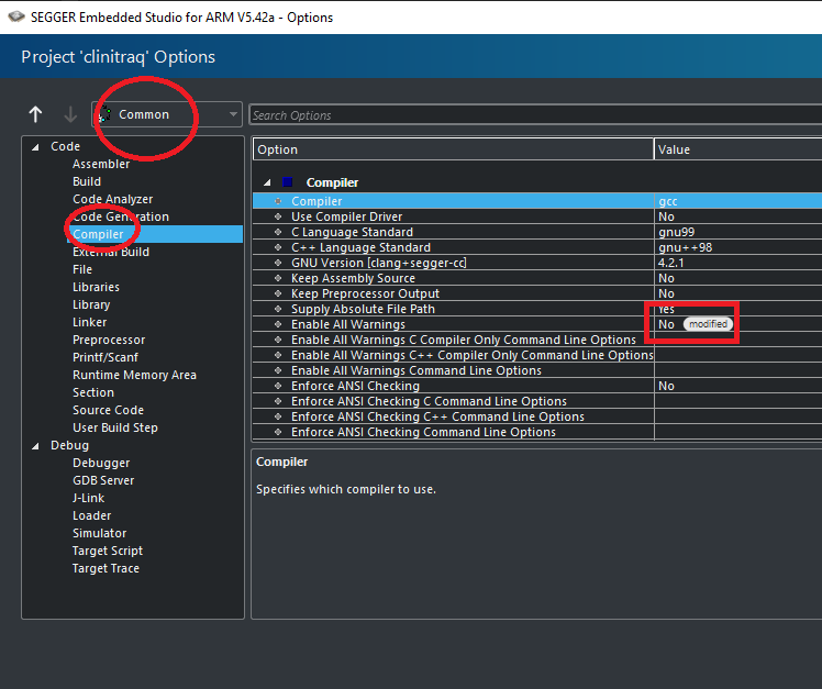

    You need to change the settings of your warnings as below

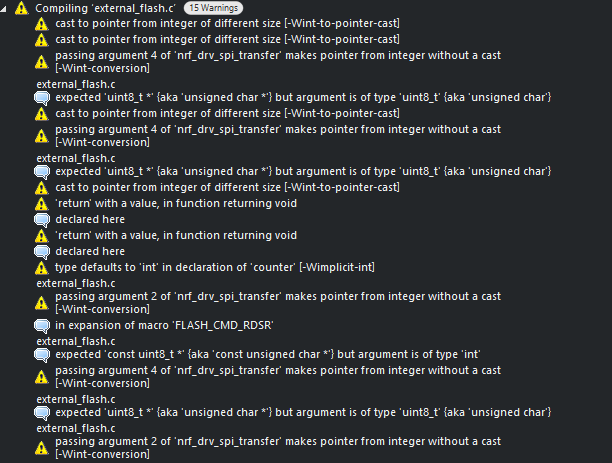

    You will then be able to see that there are a lot of warning for casting issues.
    I do not want to spend time debugging your casting issues which likely could cause stack corruption with invalid pointer dereferences or other wrong casting side effects.
    Please fix your warning in your program to be able to gain confidence that what you are debugging is logical problem and not an issue with doing casting that is confusing the compiler and creating wrong code..
