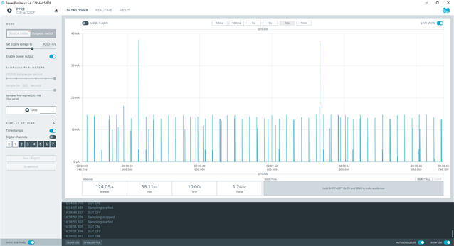

When running above mentioned examples, there are significat power consumption differences.
When running example from SDK v4.1.0 average consumption is around 120 uA. When running same example with SDK v4.2.0, the power consumption is idling at 11 mA.
I was measuring consumption with the
zb_set_rx_on_when_idle(ZB_FALSE)
 for both of the cases.
with SDK v4.1.0with SDK v4.2.0
Is there any example in SDK v4.2.0 that would match power consumption as in v4.1.0?

  • Hello again,
    We are not seeing this difference in power consumption between the two different versions of the SDK. Though the power consumption you are getting in version 4.2.0 looks surprisingly similar to the power consumption we are seeing with zb_set_rx_on_when_idle(ZB_TRUE);
    Could it be that you have mistakenly set it to TRUE in your application? If you are disabling it or enabling with button presses, try hard coding it in the sample instead, just to make sure.
    Elfving
    I downloaded new SDK and started from scratch, changing IEEE_CHANNEL_MASK from single channel to ZB_TRANSCEIVER_ALL_CHANNELS_MASK and back to signle channel again, hardcoding zb_set_rx_on_when_idle(ZB_FALSE) as you have mentioned, and then I have managed to lower the power consumption.
    I also noticed that switch nRF ONLY | DEFAULT on nrf52840 DK was set to nRF ONLY which explains why buttons did not work. Also, when measuring consumption I noticed that correct sequence of buttons needs to be switched (ON OFF, nRF ONLY | DEFAULT, enable power from PPK2) in order to measure correct results.
    For know, consumption is under 100uA, which is good.
    Elfving thank you for support.
    Miha
