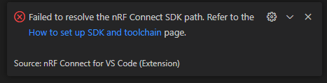

Extension conflicts with CMake Tools extension (and not auto-disabled in a non-zephyr folder)
The VSCode Cmake tools extension is tries to configure a normal CMake project when a folder with `CMakeLists.txt` is opened (every Zephyr project...). This doesn't work very well with Zephyr projects where west is the build system. As of right now, it would be great if the nRF extension could "claim" the folder or indicate a potential conflict (not sure if this is possible)
Along the same lines, it would be greatly appreciated if the nRF extension didn't try and run on folders that are clearly not nRF firmware projects (currently just generates spurious errors).
My ideal solution to the above would be for the nRF extension to act through CMake tools somehow (particularly for highlighting / suggestions / etc). The CMake Tools extension provides very accurate errors / highlighting / etc and also removes the current conflicting "claims" on the folder

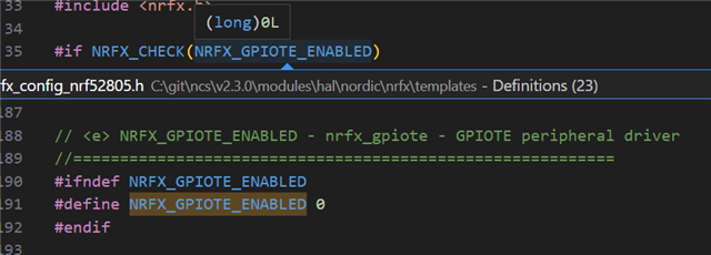

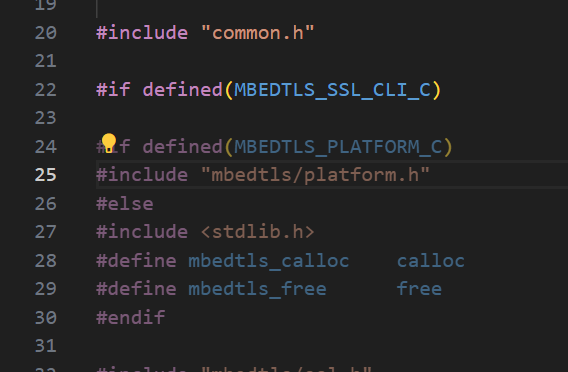

  • I think the C++ extension may be having issues with any Zephyr "module", not just one added through ZEPHYR_EXTRA_MODULES or just include directories (also what I thought was a fix before didn't continue working. I have no idea how I got it to work for a little while, but it's definitely not the problem I initially thought it was)
    mbedtls is a very obvious example as all of it's source files are wrapped in
    #if defined(MBEDTLS_FEATURE)
    and no matter what the options are enabled, the code is always highlighted as
    if the option was not defined. Using ssl_cli.c as an example, opened by
    clicking on the file in the "nRF Connect SDK/modules/crypto/mbedtls/library"
    folder (note that the debugger has no issues stepping through these files)
    files under "zephyr", "nrf", and "nrfxlib" seem to work fine, it's just
    modules that are sketchy (including hal/nordic/nrfx)
  • Thanks for reporting. The VS code team have the following answer to this:
    That's a proper bug in the extension - actually, it's two:
    • On Windows, the TF-M build system appears to be writing source files with a capital letter for the drive in the source file path (C:\), but the Microsoft C++ extension converts all drive letters to lower case. Windows paths are case insensitive, but our source file lookup wasn't, so we ended up using the includes for the wrong file in TF-M on Windows.
    • MBED uses #include MBEDTLS_CONFIG_FILE to link in the configuration, but cmake inserts an extra escape character before the quotes in defines, which we don't properly un-escape. This breaks this include statement, and defines like MBEDTLS_SSL_CLI_C are lost.
    Both issues will be fixed in the next release, which is scheduled for the end of next week. I believe the NRFX_CHECK define issue is a different problem originating from the Microsoft C++ extension, similar to https://github.com/microsoft/vscode-cpptools/issues/3109. The go to definition call works just fine if I copy it out of the NRFX_CHECK macro to the line above, so it's being evaluated differently when passed to the macro, for some reason. I can't seem to reproduce it in a reportable manner, but I'll try to make an issue for the C++ extension all the same. It'll likely take a bit longer before it's fixed though.
  • Can confirm that the issues mentioned previously now appear to be resolved
    • Out of tree driver is now not showing random errors on includes
    • mbedtls source is correctly highlighted

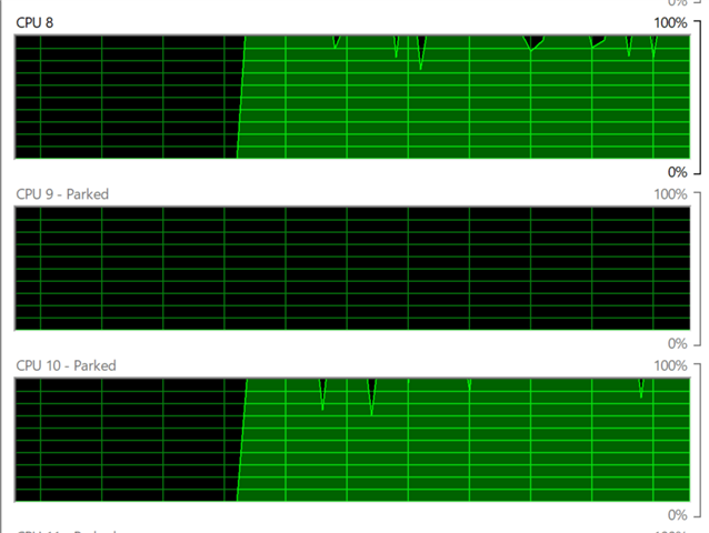

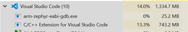

    The next major issue on my list would be the idle CPU usage and general lack of responsiveness of the extension
    The above was captured after ~5 minutes of no code changes (project has been open for a long time) on an i7-12700. I'm also seeing noticable lag in the on-hover tooltips (lots of "Loading..." before displaying the content)

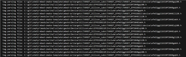

    ^^ Is taken from the C/C++ log view (log level turned to Debug). This is occurring with no files currently open and never seems to complete

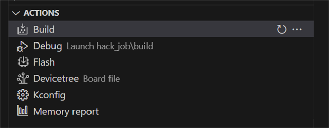

    Speaking of inconveniences, Actions has a few edges that could be smoother
    It would be good to be able to configure a few defaults for the actions buttons
    • "Erase and Flash" is *much* faster than the default "Flash" action and I generally do not need to use the slower option. Would be great to be able to swap the default here
      • Also would like to use this for "Debug" as well
    • "Flash" action does a build first, "Debug" doesn't. While I do get the reasoning to allow this, making it the default is frustrating. An easy way to change this default would be greatly appreciated
      • There is the "preLaunch" launch config option, but a) not sure how to refer to the build action and b) it hardcodes the build folder and again not sure how to get around that
