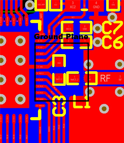

Please help me clear a query as we know we must maintain the 50ohm impedance in the RF Track.
Someone suggests I maintain the ground clearance between the 1st Component of the Matching network as shown in the image-
If we did this as per my knowledge we could not maintain the 50 Ohm Impedance(if we provide clearance for C3 GND Pin). Please correct me if I am wrong.

    The ANT pin is not 50Ohm so looking from L1 and in to the ANT pin we don't need it to be 50 Ohm's. But out from the L1 and towards the antenna then the transmission line should maintain 50 Ohm's.

    Please also confirm that the recommended image as shown is based on nrf52832. Right!
    ->I will remember it for further Design but also clarify my point for C3 we have to provide the ground plane clearance or not as shown in the image below-
    -> Also please clear one more query related to nRF52833. We have to do the same procedure in clearance for the nRF52833
    After L2 we have to add a Pi network and maintain a 50-ohm impedance. Right!
    Correct, but there is some modifications, removed some components on other pins for less visual clutter.  We do have some guides on HW design here here  https://devzone.nordicsemi.com/guides/short-range-guides/b/hardware-and-layout/posts/nrf52832-specific-pcb-guidelines  and here https://devzone.nordicsemi.com/guides/short-range-guides/b/hardware-and-layout/posts/general-pcb-design-guidelines-for-nrf52
    There are two reasons to why the layout is at it is. Firstly it serves as the matching to get to 50 Ohms, and secondly it serves as a filter for harmonics. So the specific layout helps suppress the unwanted harmonics.
    So we highly recommend that you include the keep out zone/ground plane cleared area on the top layer for best performance.
    Yes, also follow the layout example we have here for best performance.
    The Pi network is just an example of what can be used for properly matching the antenna. A T or some other network is also perfectly fine, and if you are using a specific antenna that has some recommendations in terms of matching components then use that. But we see that in most cases the typical Pi network placed close to the antenna works great.
